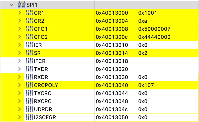

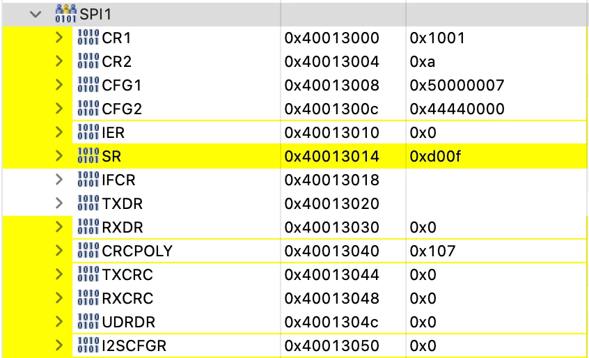

The 'H7 SPI is overcomplicated and I don't use the 'H7, but from what I see above it appears that
  • you've set up a simplex Rx of 10 frames per 8 bits
  • as in simplex Rx mode SPI generates clocks as soon as it's enabled, it generated all 10x8 clocks and autocleared CSTART
  • SR.RXWNE indicates, that there are data in FIFO; you've already read out one word as you've displayed the RXDR register in the debugger so there is no complete packet in the FIFO already
  • you are complaining about "I didn't get any data" but that probably means that you are receiving all 0s, which may be due to incorrect GPIO setup, that's why I said to read out and check the relevant GPIO registers content and also observe the SPI signals using oscilloscope or LA

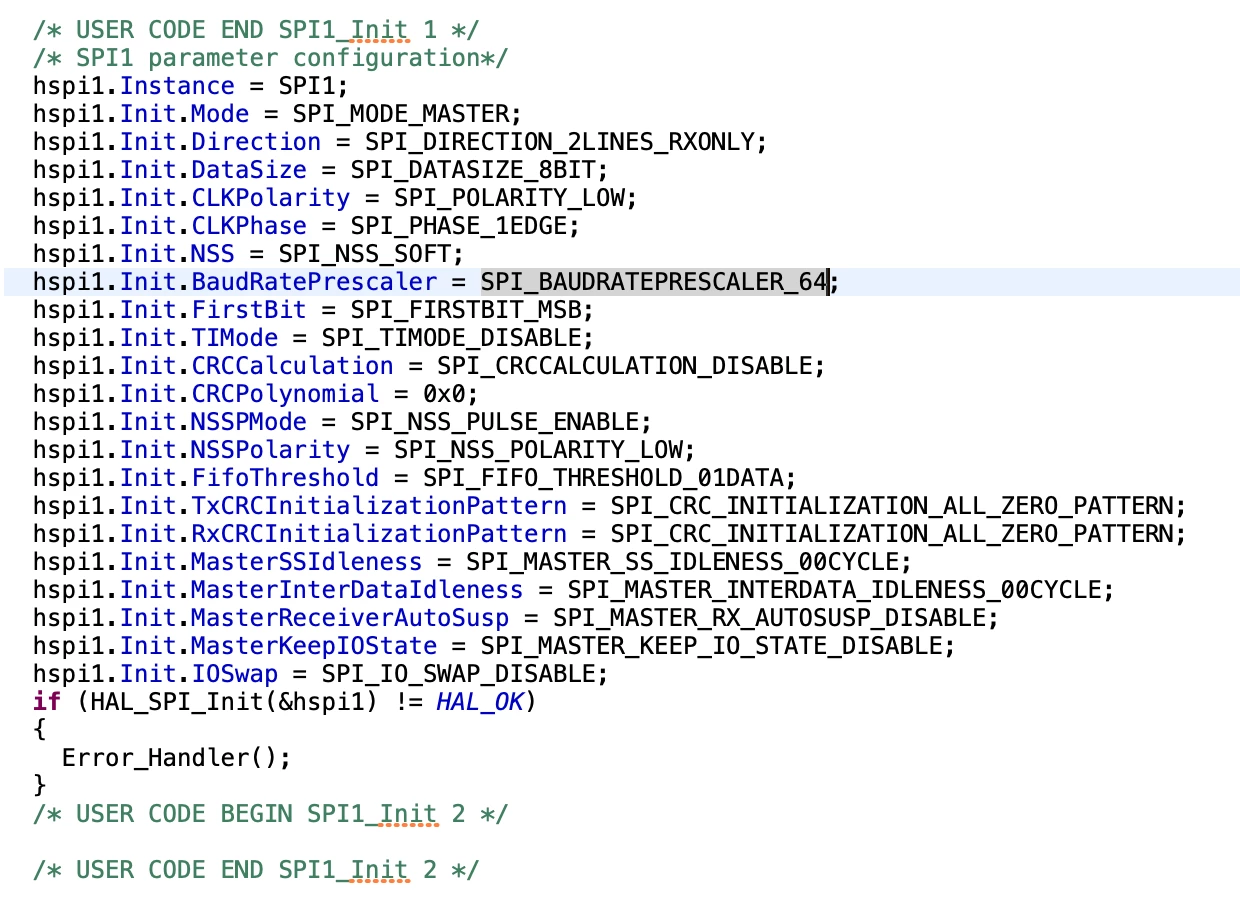

This is my set up:
The intend to test the various operation modes: polling, IT, DMA.. Already tried all of them but got the same issue. By now I'll be happy to see it functioning just in the polling mode, for this I'm using HAL_SPI_Receive(&hspi1, buffer, 32, 100).
This is the SPI1 register before the: SET_BIT(hspi->Instance->CR1, SPI_CR1_CSTART);
This is right after:
