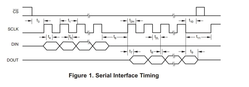

Hi everybody,
I wanna know if its possible to use DMA SPI for drive the ADS1256 or similar where I can ''stop'' the tranfer to wait until the time to convert T6 (Delay from last SCLK edge for DIN to first SCLK) of the ads.
I tried a interrupt in TX (with a TC flag and a fuction hanlder) but it wont resolve the problem, the SCLK doesnt stop.
I cant tought  in something to do with the DRDY pin.
I dont wanna bit banging its ugly but if its the only way...

    I could visualize a scheme based on timers - SCK being generated by timers chained for the non-standard waveform (and perhaps being also triggered by the DRDY signal from the ADC?), while the SPI module would be configured as slave.
    (This could btw be also the answer for those who need to issue a framing signal with SPI).
    I don't say it's simple or easy; the devil known to live in the details may even make it non-viable.

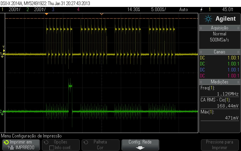

    Thankswaclawek.jan for the reply. I give up from DMA and now I am trying with normal SPI. And guess what? More problems. :( The clock appear with a latency that I can take off by removing ''
    while (SPI_I2S_GetFlagStatus(SPI1, SPI_I2S_FLAG_RXNE) == RESET);
    But when I do that I read wrong the data. The 3 last bytes is what I have to read from ADS1 The first byte is the command for read the conversion (ADC). Here's the code:

    And here's the latency. If I use the
    SPI_BaudRatePrescaler_32; on 128 the latency go away. But its too slow.
    0690X00000604s8QAA.png I hope somebody can help me cuz I really need this done and I have no ideia what is going on.Thanks
