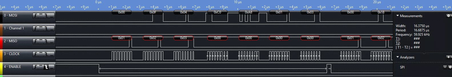

We are working on STM32F417.We are getting a ''problem'' (if it is a problem) with the SPI through DMA.The function which send data through SPI is selecting the device at the beggining and unselecting it after the transfer.With a normal SPI transmission we get the ''unselect device'' right after the transmission is completed, for any baud rate prescaler. (see printscreen with a baud rate prescaler of 8)

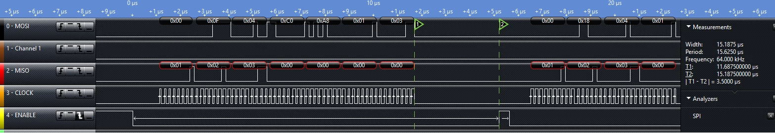

Now, if I am using the same baud rate prescaler and the same data are send. We are getting a delay after the transfer is complete. The fact is that the duration of the chip select is the same as for Normal SPI transfer. (see printscreen with also a baudrate prescaler of 8)
For a baud rate prescaler of 4, the DMA transfer is faster (sure it is) and so the delay is longer but almost the same as a baudrateprescaler of 8.Also, with less data to send, the chip select keep the same duration in DMA mode.Do you have any idea where this can come from?Thank you,Marc #dma-spi-tx
