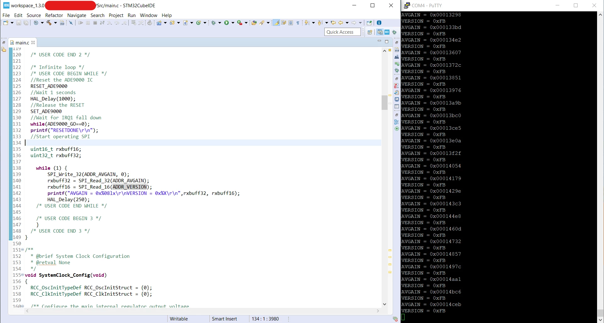

I bought anADE9000 Shield Eval Board. I am trying to interface it with an STM32F429ZI-Disco board. My problem is about data i read through SPI are not as expected according to the register table in the datasheet. I attached my program and my serial port capture. Could you help me please ?
My SPI Configauration:
SPI Speed : 10 MHz
SPI Mode 0
CRC Disabled
8 Bit data length
MSB First
