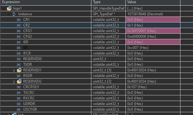

I'm trying to setup a SPI communication through DMA but I can't receive data.
I use a STM32H7 microcontroller as a single master to reach a single slave. I would like to transmit 1 byte, and receive 1 byte in return. To start the transfer, I call the HAL function :
HAL_SPI_TransmitReceive_DMA(&hspi1, au8BufferTx, au8BufferRx, 1);
au8BufferTx and au8BufferRx are both 129 bytes big, which should be more than enough to transmit/receive 1 byte.
The DMA1_Stream2_IRQHandler() (I use DMA1_Stream2 to transmit) is first called when the byte is transmitted, then DMA1_Stream5_IRQHandler() (I use DMA1_Stream5 to receive) when a byte is received. As I undretsand it, it means that DMA transfers are completed. Then HAL_SPI_TxRxCpltCallback() is called. Though, the content of au8BufferRx is never updated. Any idea on what is happening there ?
Thank you for helping
More info :
  • Before trying to setup DMA, I used SPI with IT. Everything worked as expected. That's not a hardware problem on my platform.
  • I checked MISO and MOSI signals with a scope, they are as expected. That makes me think that the microcontroller receive the correct answer on MISO signal.
  • SPI1 status when entering HAL_SPI_TxRxCpltCallback() function
