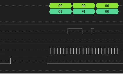

I'm currently stuck in the While CNDTR != 0 condition.
I think my counter should be decrementing, but it never does, and I don't see any information on the SPI bus...
If you have any ideas ?

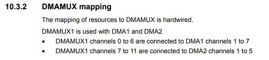

PS.I would set up DMAMUX before enabling DMA; and also the DMAMUX channel assignment may be wrong:

waclawek.jan
waclawek.janBest answer
Aug 5, 2025 2:43 PM UTC
> Is correct to configure and/or enable DMA after SPI clock ?
Probably yes.
As I've said and gave a link above, your problem may be incorrect DMAMUX channel - for DMA channel 1 you need to set up DMAMUX channel 0.
Quentin_27
Aug 5, 2025 2:54 PM UTC
Thanks, for your reply,
Now it's work,
I just haven't understand the channel0_DMAMUX1 was on DMA1...
I will now set the rx method, if I can help anyone my code below:
