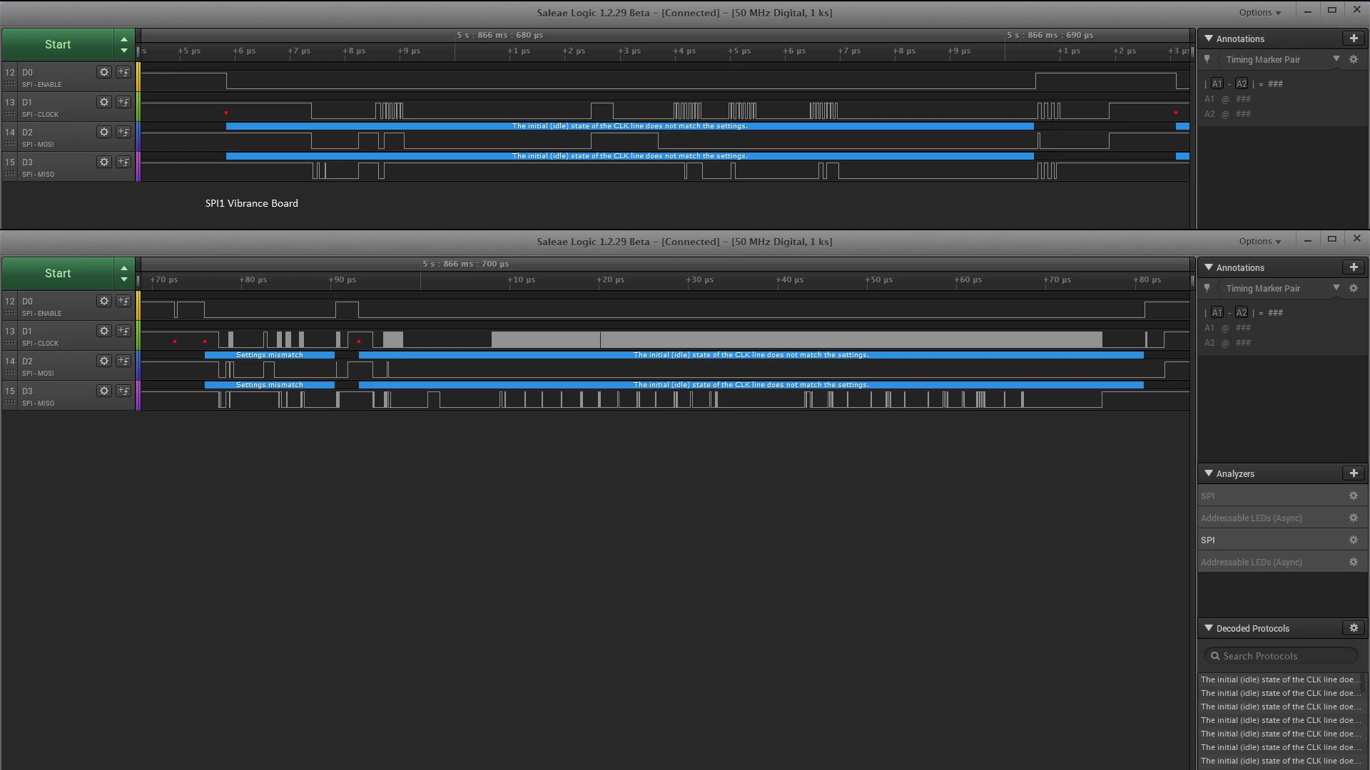

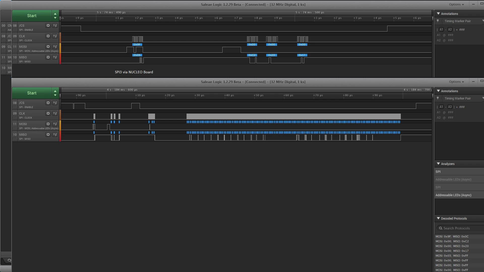

Hi
I'm trying to read an EEPROM connected to SPI1 and facing difficulties. For some reason the clock is off by being idle high. This doesn't happen if I use SPI3 and am therefore wondering if there's some characteristic or further configuration that is required with SPI1?
Note that I'm using PA4 for both scenarios but this is a manual process anyway; send PA4 low, interact with SPI, send PA4 high. However, I cannot see this being an issue. I've attached a couple of images showing the results as follows:
SPI1 (bad):
SPI3 (good):

Can appreciate that immediate thoughts would be to stick with SPI3 but unfortunately there is functionality required using the GPIO port C pins and therefore really needs to go onto SPI1. Any thoughts, insight and suggestions would be greatly appreciated.

Thanks again for responding and sorry I've not updated sooner. Yes, I checked but more importantly I found that the connection was a little dirty; a quick clean and everything appears to be working fine now.
