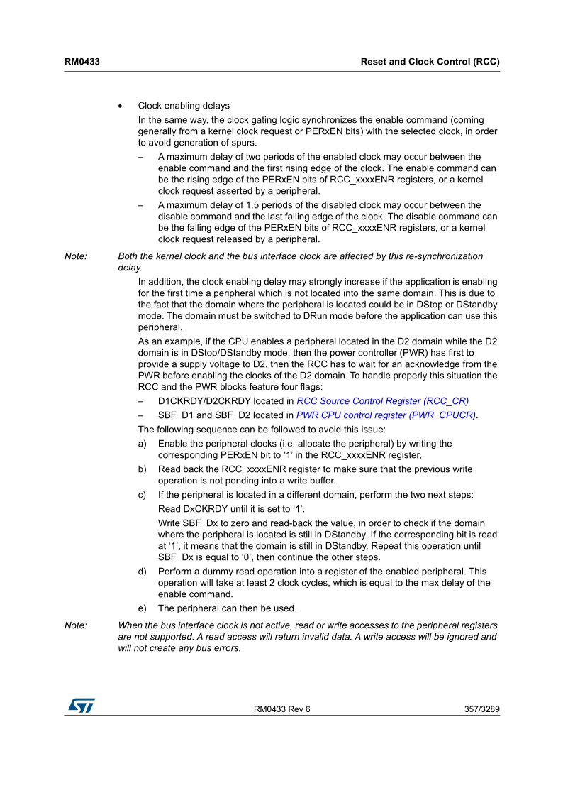

Read out and check the SPI and relevant GPIO registers content.
Observe the delay needed between enabling peripheral clock, and writing to given peripheral's registers:

There is no delay between these two lines:
> RCC->APB2ENR=0x00102000; //Enabling SPI45 clock (default: rcc_pclk2=25MHz)
> SPI4->CFG1=0x30070007; //Baud rate = SPI clock / 16 = 1.5625 MHz, No CRC, 8 data bits
so SPI4->CFG1 might get written while clock is not effectively enabled, yet.
