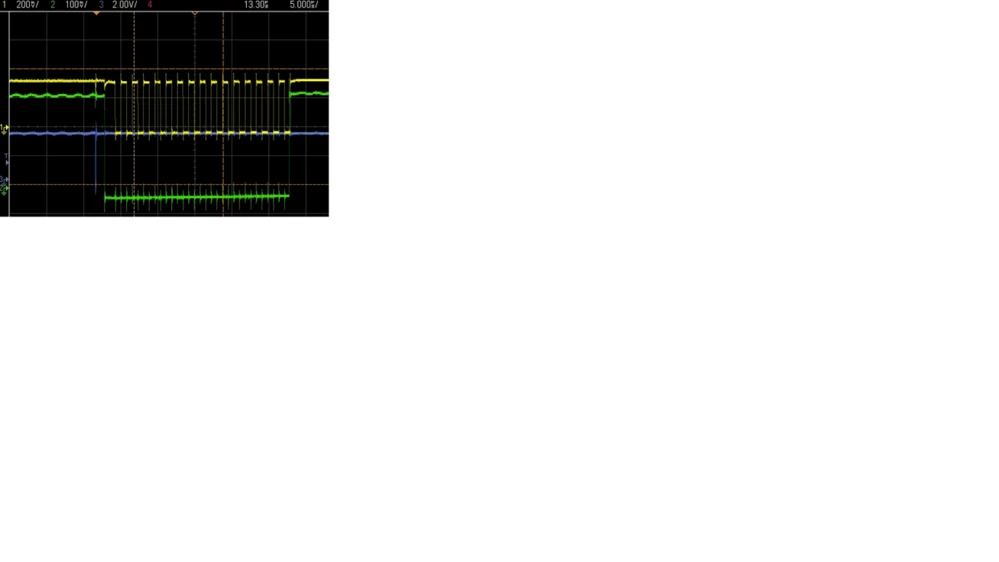

I am working with communication between stm32F4 SPI2 to small A/D read only. The reading process is only one 16 bit word so I using SPI2 as a Master and my configuration looks like this:
SPI_InitTypeDef SPI_InitStructure;
SPI_InitStructure.SPI_Direction = SPI_Direction_2Lines_RxOnly;
SPI_InitStructure.SPI_Mode = SPI_Mode_Master;
SPI_InitStructure.SPI_DataSize = SPI_DataSize_16b;
SPI_InitStructure.SPI_CPOL = SPI_CPOL_High;
SPI_InitStructure.SPI_CPHA = SPI_CPHA_1Edge;
SPI_InitStructure.SPI_NSS = SPI_NSS_Soft;
SPI_InitStructure.SPI_BaudRatePrescaler = SPI_BaudRatePrescaler_64;//64;
SPI_InitStructure.SPI_FirstBit = SPI_FirstBit_MSB;
SPI_InitStructure.SPI_CRCPolynomial = 7;
SPI_Init(SPIx_APIT, &SPI_InitStructure);
When I processing read command I am using this :
uint16_t Get (void)
uint16_t val1 = 0;
ADCx_TRIG_LOW();
ADCx_TRIG_HIGH();
DelayPit(20);
SPIx_APIT_CS_LOW();
/*!< Wait to receive a byte */
SPI_Cmd(SPIx_APIT, ENABLE);
while( !(SPI2->SR & SPI_I2S_FLAG_RXNE) ); // wait until receive complete
SPIx_APIT_CS_HIGH();
Val1 = SPI_I2S_ReceiveData(SPIx_APIT);
SPI_Cmd(SPIx_APIT, DISABLE);
DelayPit(1);
return (uint16_t)(val1);
When ADCx_TRIG is an I/O that initiated sample from the A/D and the SPIx_APIT_CS config as a I/O.
This code is working good as you see in the first figure (yellow is clk, grin is CS and blue is trig for A/D)

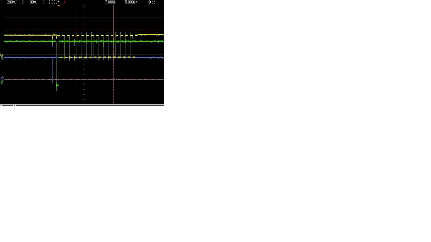

Bat sometime (one in 300) the CS is up before time see the second figure and then I get fault data in my reading.
Is there anyone that can help me?
