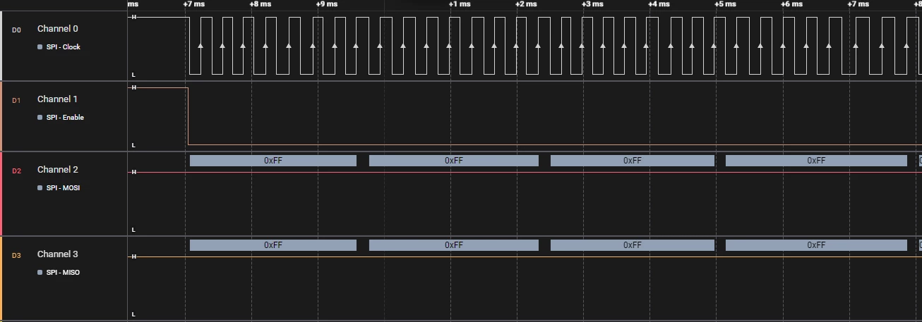

SPI constantly sending Clock and OxFF over MOSI after enabling SPI in half duplex.
  • January 31, 2026
  • 246 views
I have been trying to communicate with an SPI peripheral (NOR Flash). I want to use SPI in half duplex mode. The problem is that as soon as enable the SPI peripheral I see SPI constantly sending OxFF over MOSI even though I have not written anything on the SPI DR register.
Pasting the screenshot of the Salea LA
Below is the simple SPI TX code

In half duplex mode, you need to toggle between sending and receiving. When receiving, it is clocked constantly as shown in your logic analyzer traces.
February 2, 2026
Hello @milindmishra87
The 0xFFs and clock activity after enabling SPI is normal behavior of the SPI master.. /CS does not stop the SPI peripheral from toggling SCK/MOSI; it only tells the flash when to pay attention.
To be sure there is no issue with your NOR flash, I recommend verifying the CPOL/CPHA, and half‑duplex direction bits and sharing your SPI register dump just before starting the transfer.
