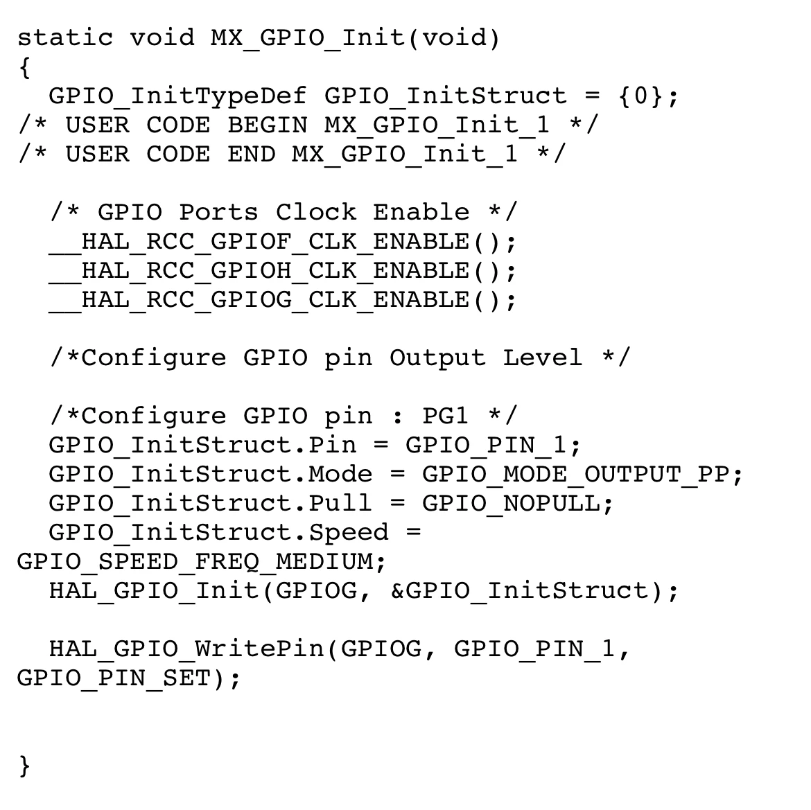

The code is attached for your reference
The issue is not getting any data from CS5532 (it continuously giving FF as an output due to pullup.

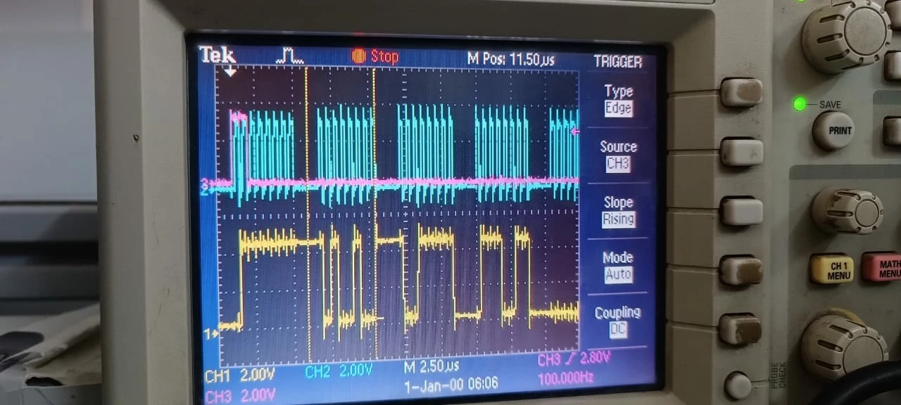

When I interfaced CS5532 with another microcontroller(ESP32), I got the output properly as shown in ESP32 (Expected) image (Second image).
Yellow line : MISO data
Blue Line: Clock 2MHZ
Pink line: MOSI data (0xC0)

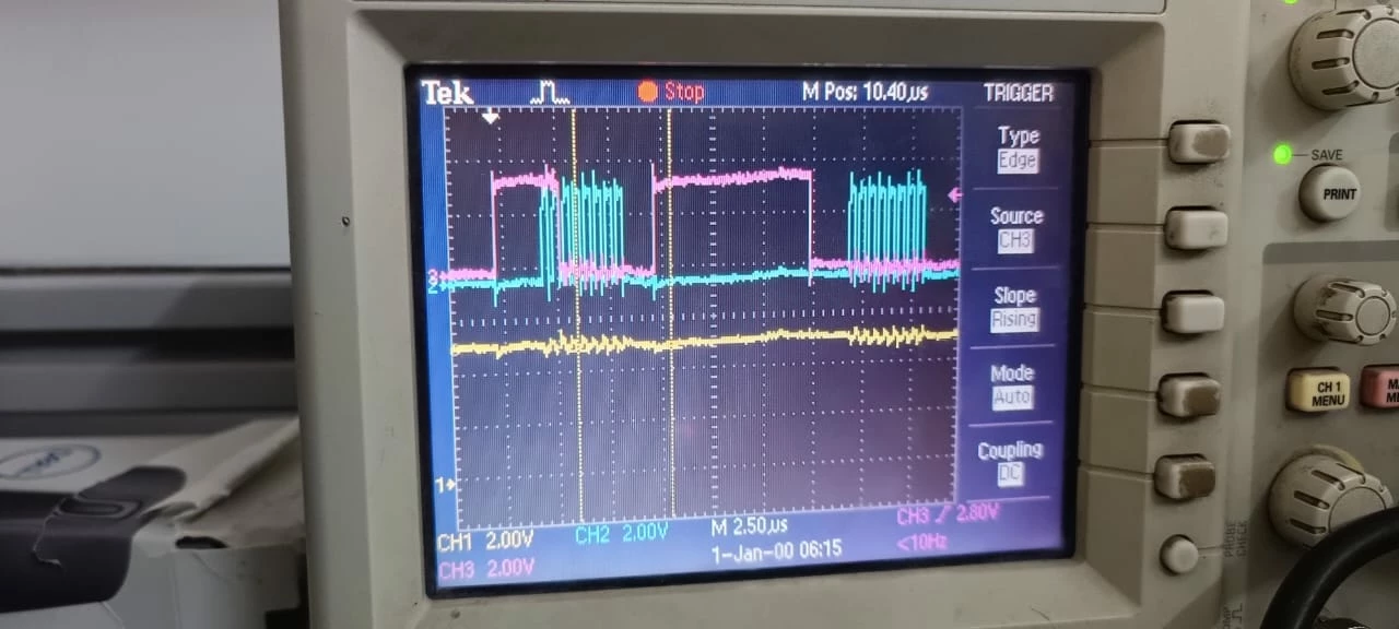

But when I interfaced it with STM32 I didn't receive any signal.
The clock pulse is having set of 8 cycles (8 bit data). So while interfacing with STM32 the MOSI signal goes to high between two sets of clock pulses.

Thank you for the follow up. This is two last suggestions :
1) in the code I do not see SPI5 GPIO configuration: MOSI, MISO , SCK pins in Alternate functions or I overlooked the code .
There are only clock enable if 3 ports F,H and G and configuration of PG1 ( CS) in software and No PF7-9
2) try another SPI port for debugging purposes and using our reference code examples .

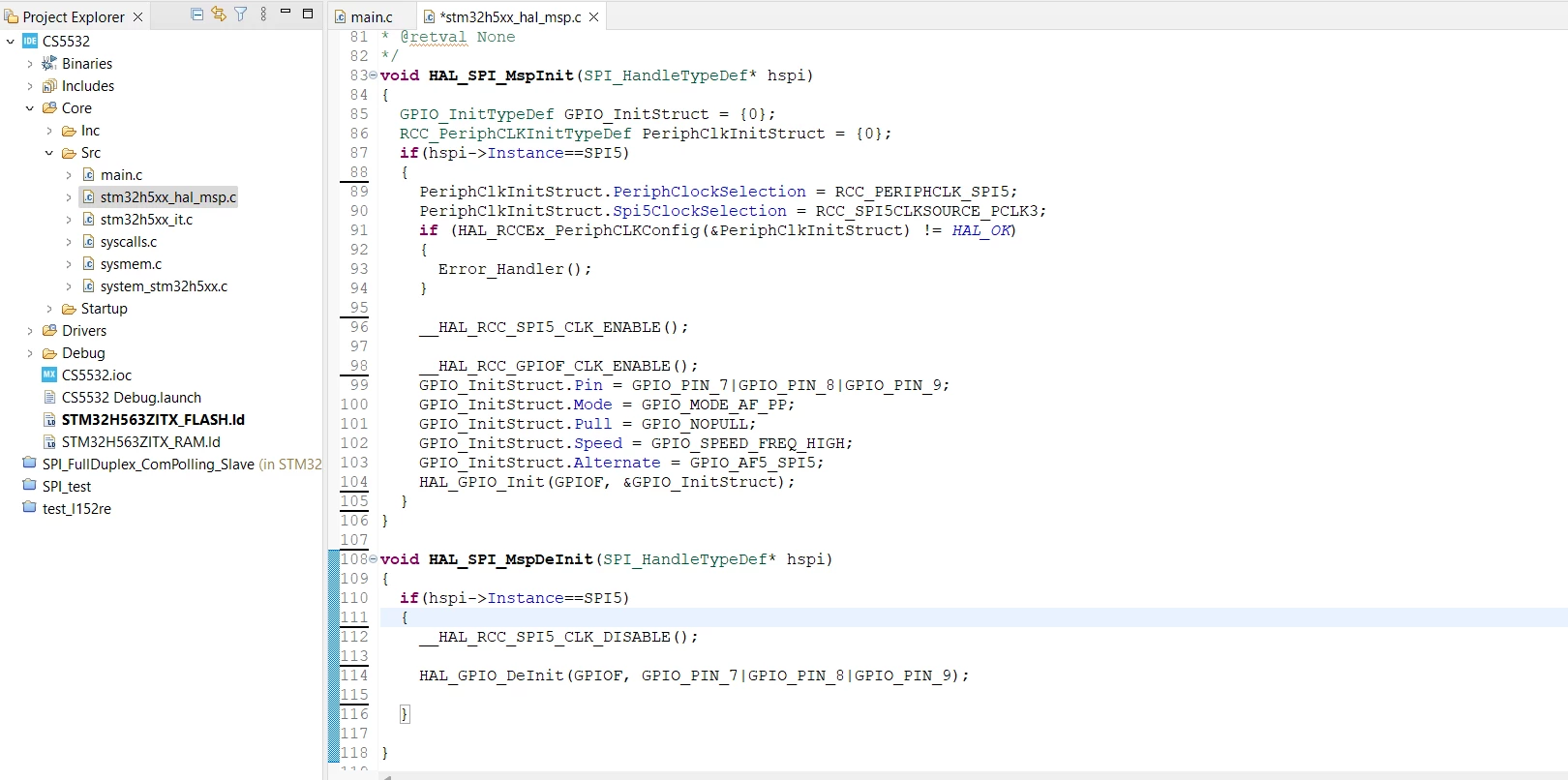

digambarAuthor
July 26, 2024
These functions are included in stm32h5xx_hal_msp.c file which is generated by stm32cube.
I have also tried it with spi3 and spi1 and facing the same issue
