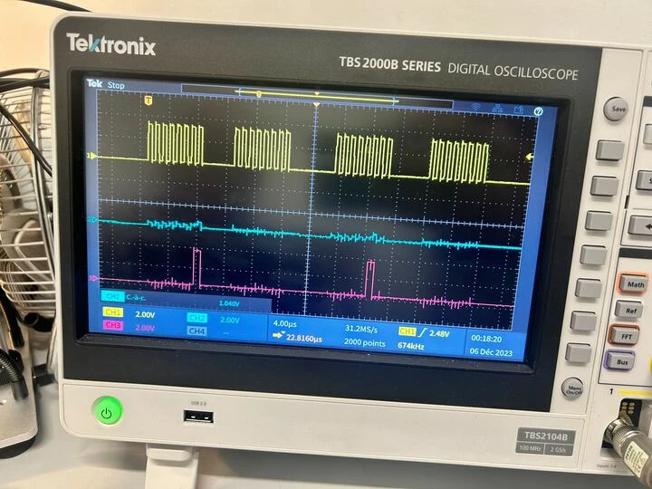

With all those configuration, it should work but, when I plug in my scope here is what I observe:

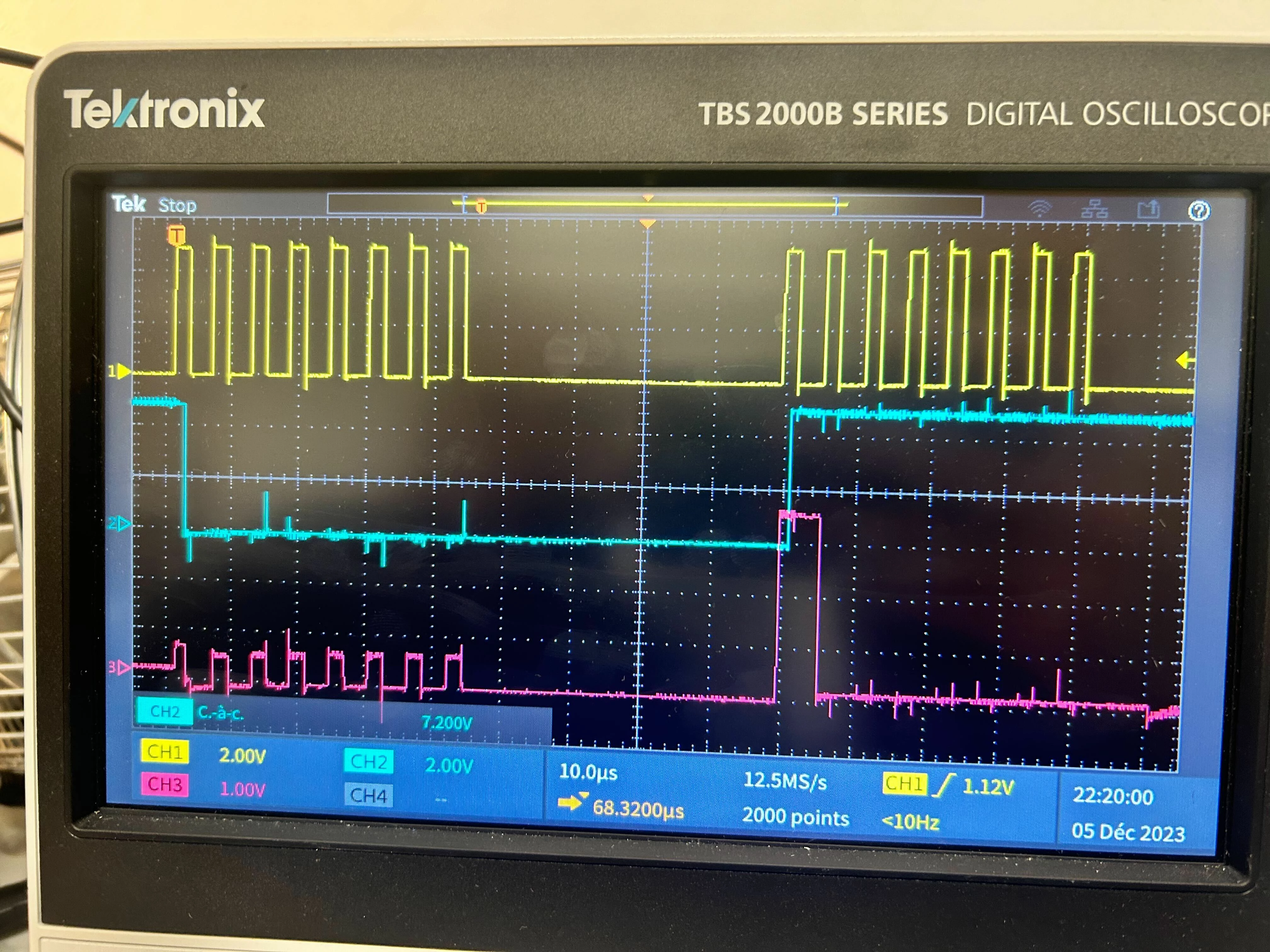

In order to debug, I tried to plug the Arduino over the scope and here is what is observed:
For both captures, the signals are:
  • Yellow = SCK
  • Blue = MOSI
  • Purple = MISO
The first question that comes to my mind is: Why when the Arduino is plugged, the MOSI is always set to '1' except when transmitting data while STM32 is always set to '0' even when transmitting data? Do I need to pull up the MOSI? Why do I never receive data while the register address appears to be properly send (regardless of the register address)?

MOSI is set to '1' while not transmitting data only when I am using the Arduino setup (which is the properly working setup).
On Simulink-STM32 side, MOSI is set to '0' when not transmitting data and both data and register address are not transmitted to the "slave" board.
