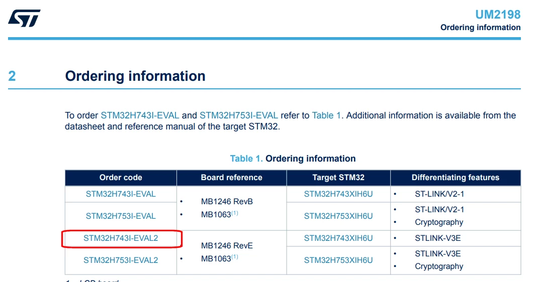

So that is one covered by the Manual I linked:
So, again, did you remove R118 ?
If not, that explains why you couldn't use PA5!

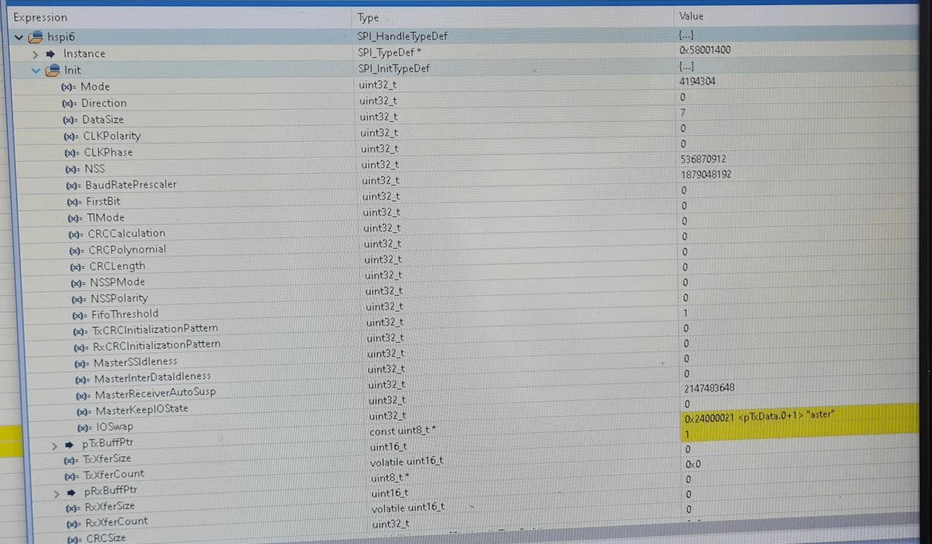

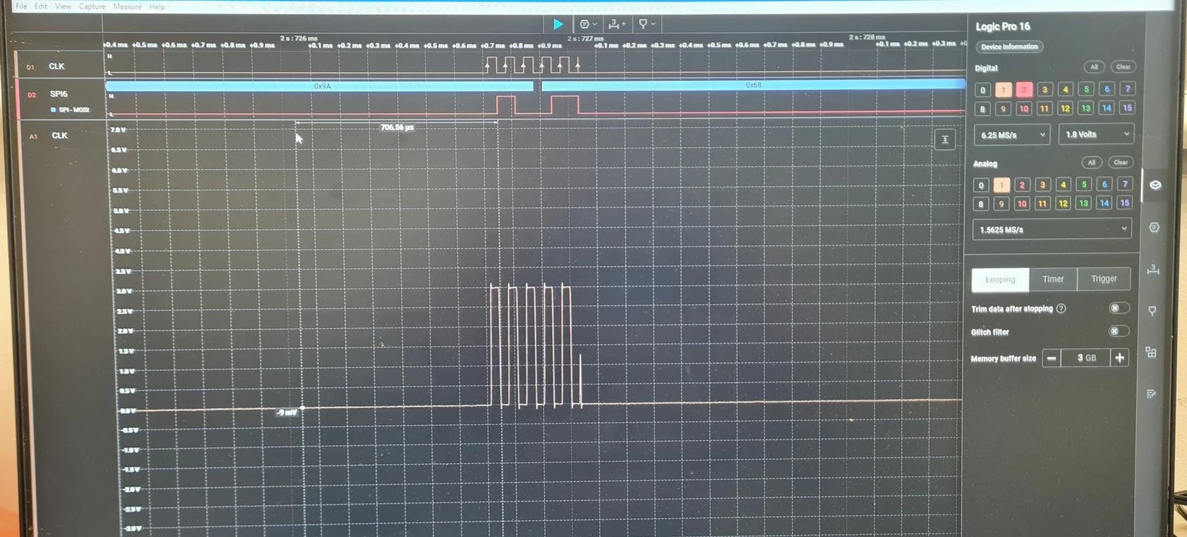

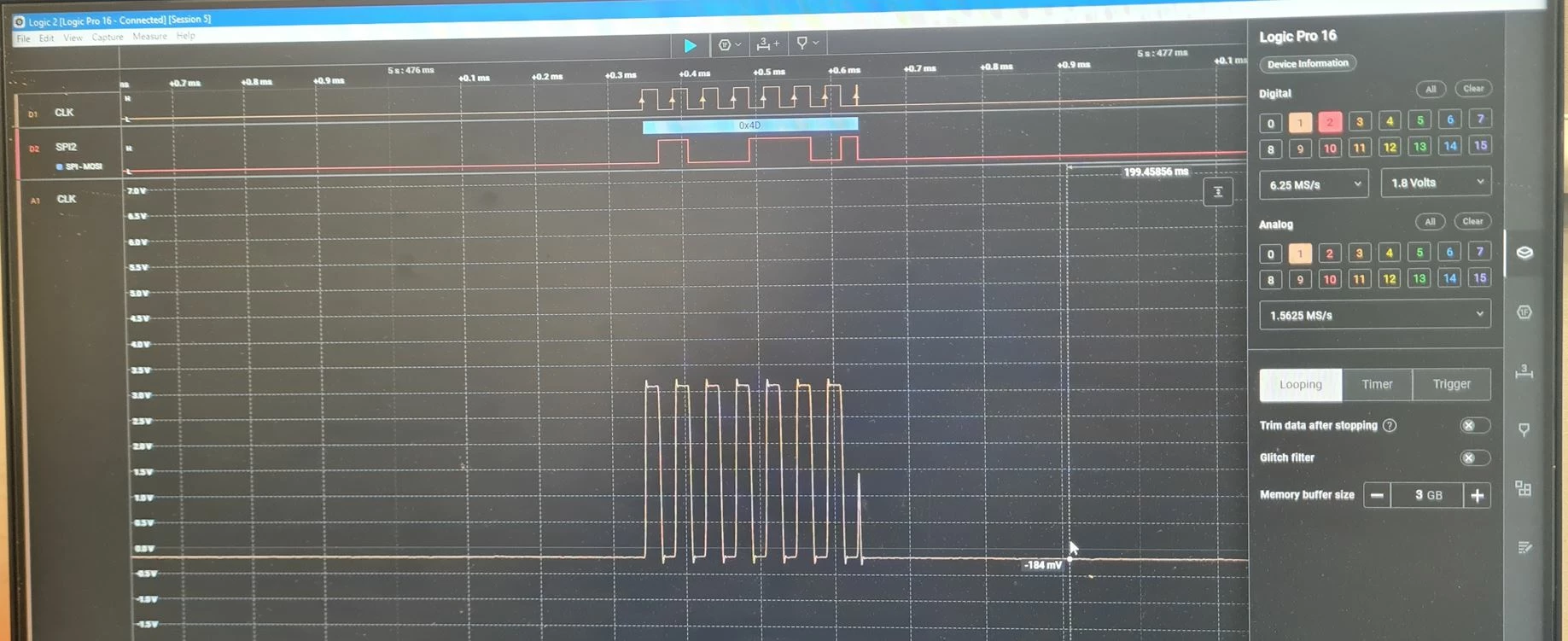

Show the contents of the SPI6 registers at the time of the error. Logic analyzer trace showing the issue would be good as well.
dorongAuthor
Feb 24, 2025 7:28 AM UTC
bad spi 5 bits on spi6bad spi 5 bits on spi6good spi 8 bits on spi2good spi 8 bits on spi2

Tesla DeLorean
Guru
Feb 23, 2025 6:15 PM UTC
Make sure to clear and populate the SPI Initialization / Instance structure completely.
By default auto/local variables will contain stack junk unless explicitly cleared, and random things can happen.
 SPI_HandleTypeDef SpiHandle = {0};

Feb 24, 2025 2:20 PM UTC
My guess is you're disabling the peripheral too early. Possibly when DMA completes but before the transaction completes. The SPI6 registers would be in the SPI6 instance, not the hspi6 handle.
In any case, your "8 good bits" are certainly not. Look at the clock line. There are 7 clocks plus a spurious edge/pulse on what should be the start of the 8th.
Showing the relevant code would be useful.
dorongAuthor
I have created only SPI 6 software to check if other resources damages spi6
but found that the same random clocks appears 4,5,6 clocks instead of 8
I have also configured spi2 exactly the same but SPI 2 clocks function perfectly.

Andrew Neil
Feb 25, 2025 8:51 AM UTC
If the "problem" only happens on one particular pin, that's probably due to a conflict on the board ...
You haven't said what board you're using.
Check your schematics. If it's a custom board, also check for manufacturing faults/errors; eg, shorts.
Maybe get a logic analyser trace which shows SPI6 working (clock on a pin other than PA5), plus what's happening on PA5 - so a total of 5 signals: NSS, SCK, MOSI, MISO, PA5.
