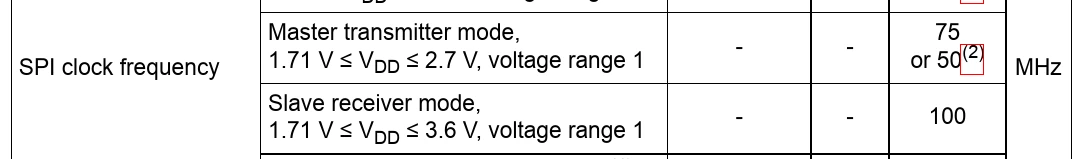

from ds :
so limit for clock/slave is 100 M.
OK, so clearly it's capable of going faster than I'm finding. So what's actually causing this issue?

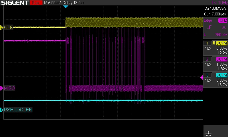

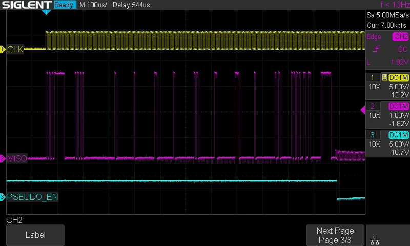

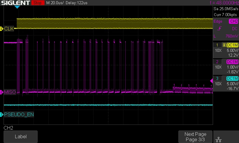

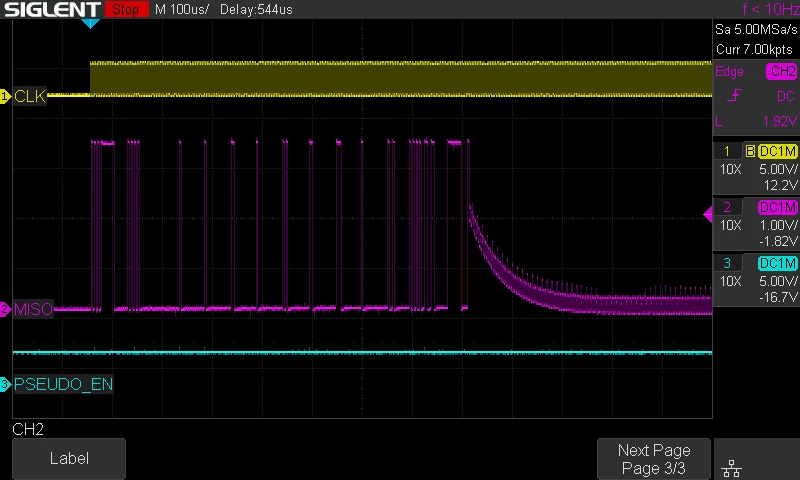

Scopeshots:
At 200kHz I get the correct frame out, and the callback triggers, sending channel 3 (PSEUDO_EN aka Green LED) low.
At 300kHz, I still get the correct frame out, but with 2 noticeable behaviors.  First, channel 3 doesn't go low.  Second, I get an extra high bit(s) after the end of the frame.
Seth K

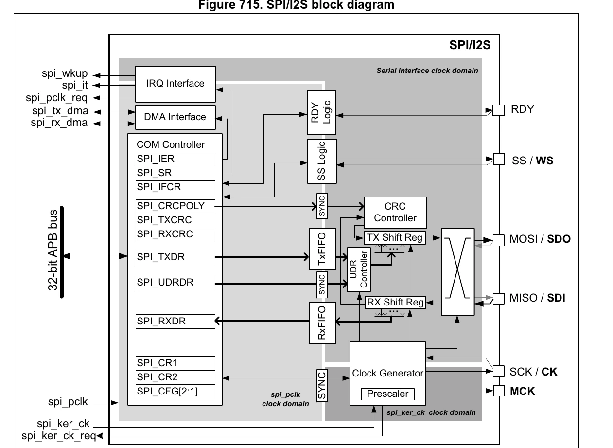

October 2, 2023

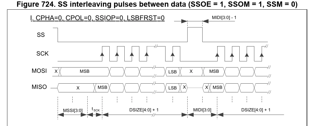

i think, you should stop this useless game. :)
spi is in frames, with some sync (nss) needed, otherwise its just nonsense.
this is the spi - so to test it in any useful way, you have to send data/clk/nss in valid frames.
look at the block diagram of this spi :
what will it do, giving constant clk as slave ..? nobody knows.
with these setting i have slave receiver from esp8266, which has curious frame packets, but works fine at 16Mbit.
so try with valid spi frame format, maybe just using other spi of this chip as master.
sethkazAuthor
October 2, 2023

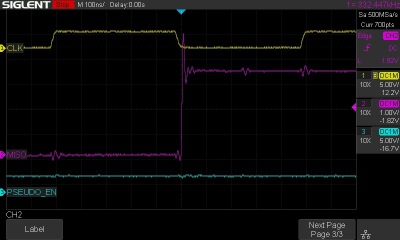

The glitching I'm seeing is more due to my current setup.  This is definitely something I will fix, but that requires making a custom PCB.  I'm trying to eliminate as many fundamental issues (like that callback not being triggered) as I can before committing to a custom PCB.
Example: 1MHz clock and the MISO line showing a good deal of overshoot along with some other noise sources coupling onto the measurement.

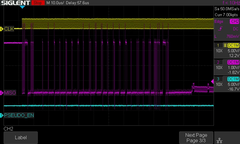

October 2, 2023
So, after manually inspecting the frames, I'm able to get a complete frame out up to 14MHz.  However, the callback is not triggering on any of these, so my problem is still there.
