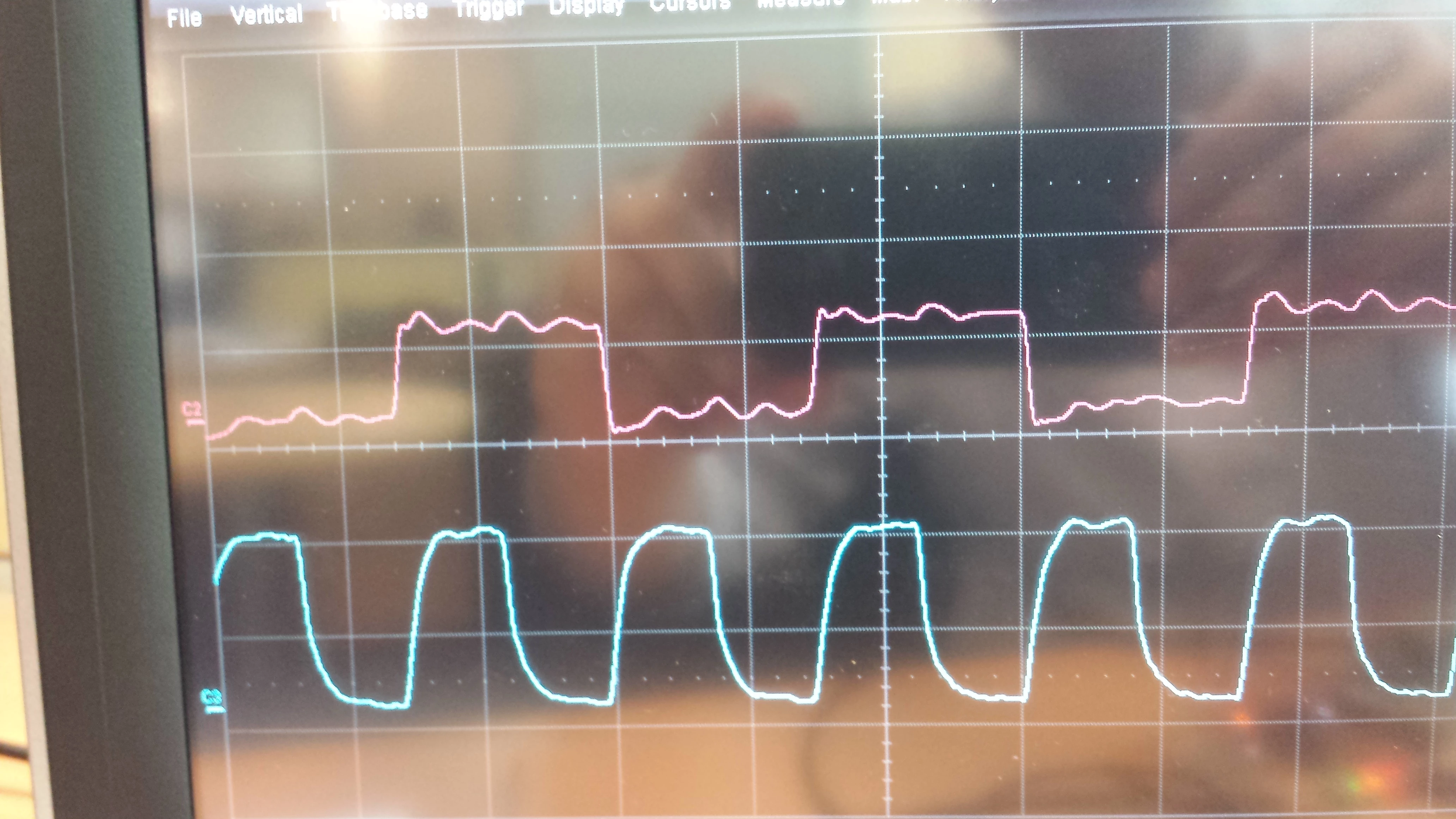

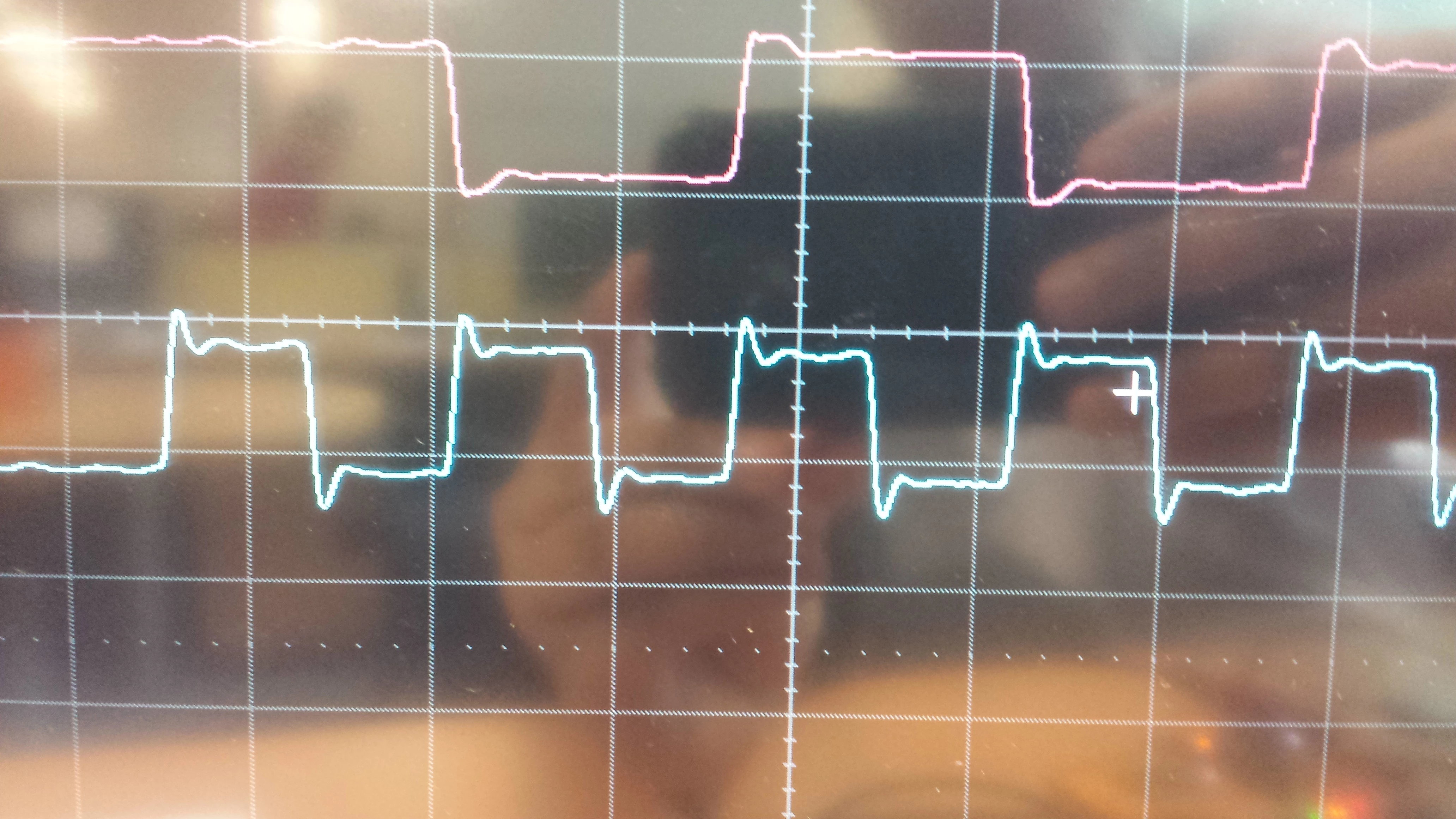

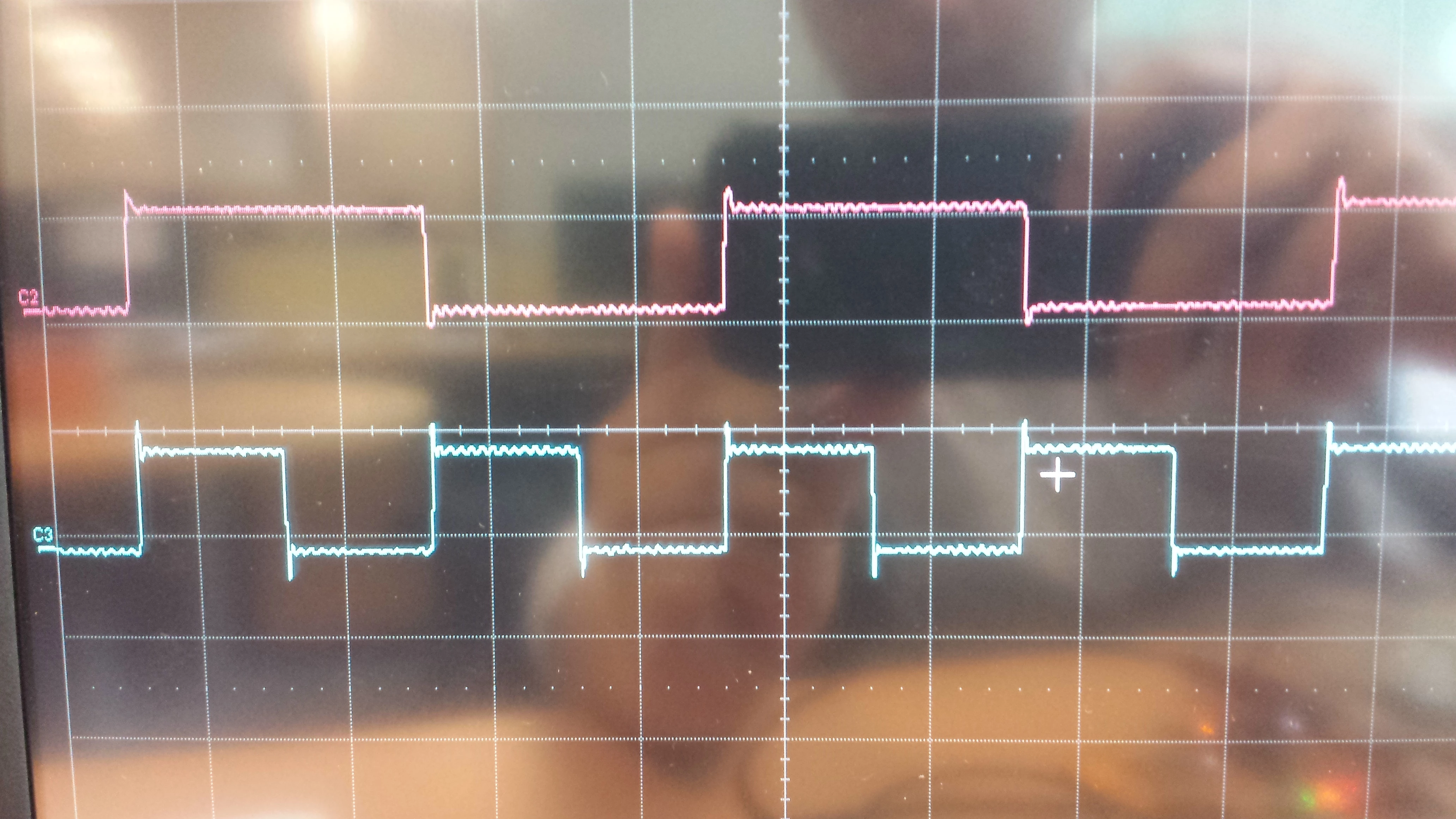

I am facing an issue with SPI communication. When the data is sent at 100khz, 250khz anf 500khz, the data reaches the slave correctly. When I increase the frequency of SPI clock to 1Mhz and 3Mhz, then the data on the SPI slave starts getting corrupted.
I have captured the waveforms at all the mentioned frequencies from the developement board side and for 3Mhz from the STM32 side. Cable length from the development board to the prototype board is 6 inches.
In all the attachments:
Pink Line is MOSI
Blue line is SPI Clock
Please share your thoughts on how to resolve the issue?

The signals in your pictures don't look that bad. Are you sure you have the polarity of the clock edges correct for the device you're interfacing? You don't say what device it is.

   Yes the polarity of the clock is OK. Actually, the SPI slave, which is the STM32 chip, is a SecureCore 300 chip, is getting correct data at clocks 100, 250 and 500 khz. When I move to 1Mhz, I see that the first bit of the MSB is incorrect, the rest of the data looks ok. Then when I move onto 3 Mhz, first byte seems to be corrupt, the data that follows is ok.

Every signal should have its dedicated return/ground wire in the cable.
Connect the oscilloscope's ground to the slave's ground and measure the signals at the slave in that way.
Also, what is the nature of the erratic data? Some bits flipped? If yes, systematically from 1->0 or 0->1; or random? Or is it bit-shift? If so, how do you synchronize slave to master, do you use NSS?
Why is data amplitude on the scope pictures different from clock amplitude? What was the Y(voltage) range for both waveforms/channels?

[Vineet]: For the last 2 questions, please refer the image attached.

And where is this signal in the picture being scoped at? The STM32 end, or the far end? What are the GPIO slew rate settings on the STM32 end? Can you shorten the cable significantly? Does that help? What's the spec say about the time from the CS/NSS low until the first clock?

The probing is done at the STM32 side which is the SPI slave. I will check on the slew rate.

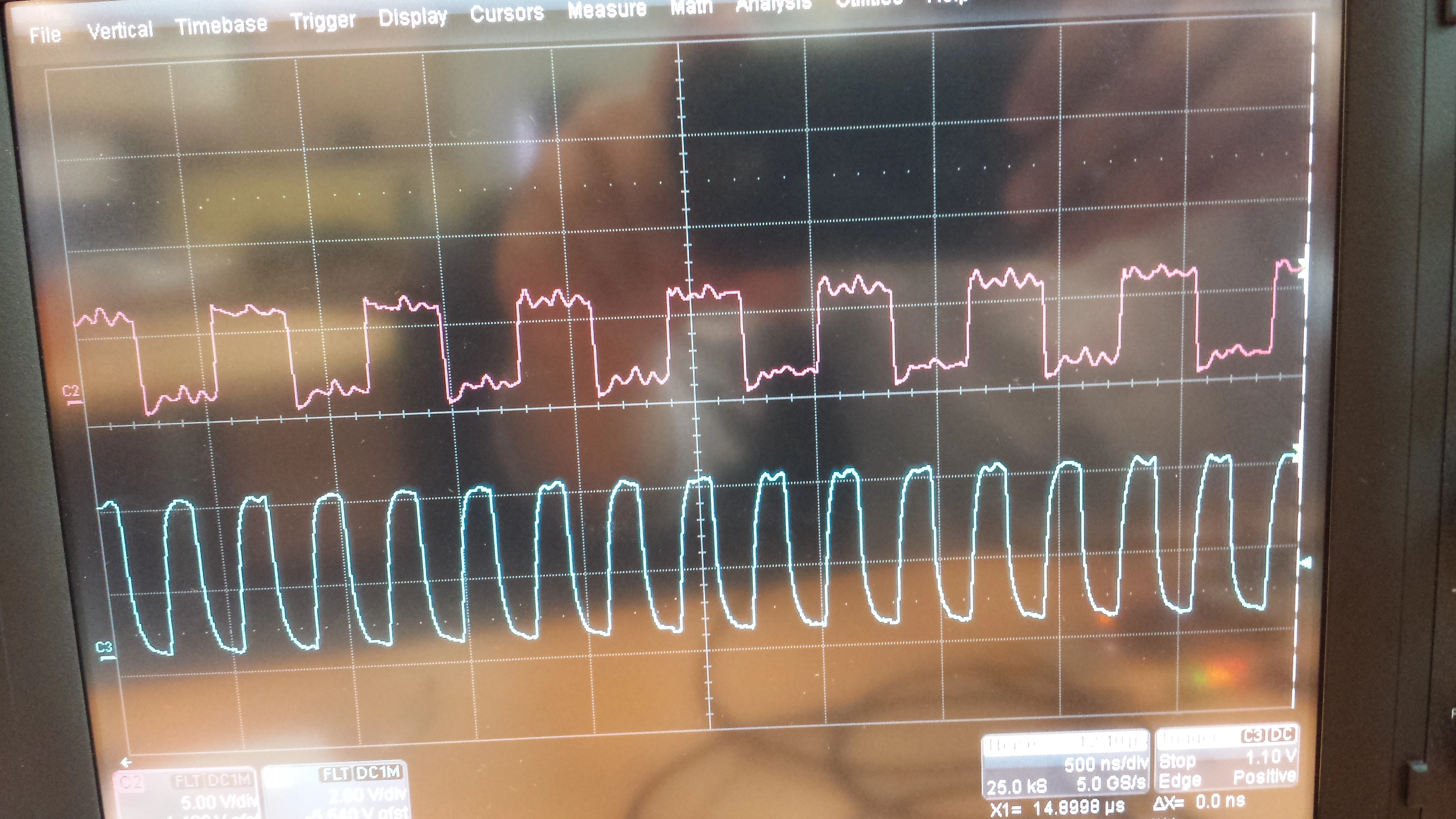

I zoomed in on the 1st byte of the MOSI line and found that for the 1st 3 bit periods, the voltage on the MOSI line is around 400mV and then lowers a little. The same thing can be observed for bit no. 10, counting from left. So instead of reading the first 3 bits as zero, it is reading as 1. Please refer the attached file. I have marked the way bits should be read and how they are being read incorrectly.
4 bits are received incorrectly counting from left: 1,2,3 and
NOTE: Purple is MOSI with 200mV/div and Blue is SPI clock with 2V/div.

   I reduced the wire length of the clock from 6inches to 3 inches. Same result. Would it help to connect a schmit trigger chip so clean up the MOSI Line?
