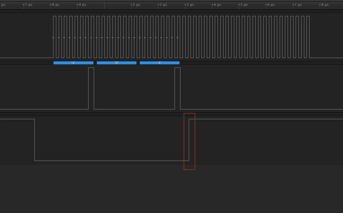

hi,I want use SPI1 as master and SPI1 reg configure as that
    SPI1->CR2 =
0x1704
;     SPI1->CR1 =
0x15C
read code is
    GPIOA->BSRR |=
1
20
//set NSS low
for
(i =
0
;i < command_size;i++)
while
0
== (SPI1->SR & SPI_SR_TXE));         SPI1->DR = out_buf
i
0xFF
while
0
== (SPI1->SR & SPI_SR_RXNE));         in_buf
i
= SPI1->DR &
0xFF
    GPIOA->BSRR |=
1
4
//set NSS high
i use logic analyzer capture the logic as
it saw that clock also driver after NSS set high.
can anyone help me

Posted on March 10, 2017 at 09:56
Release NSS only when SPI BUSY bit is cleared.

thank you for reply, my problem is that when i send 3 bytes but it have 48 clocks

Mar 10, 2017 10:27 AM UTC
Posted on March 10, 2017 at 10:27
https://community.st.com/0D50X00009XkfrtSAB
  Should give the solution.
