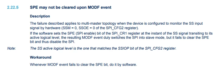

I've been trying to adapt the current SPI driver in RIOT OS to support the U5 series(STM32U585AI), due to my lack of success I've been trying to sidestep RIOT for a moment and try to do must of the setup manually. But so far I have not been able to get SPI3 to output anything, not even an SCLK signal, leading me to believe that I've just missed something simple like some clock domain etc.

However step 8, specifically setting the SPE is where the problem becomes apparent, the SPE bit does not stay enabled. Does anyone have any hints on where to look to get this running?

Hello @mdr and welcome to the Community :)
It seems you have encountered the condition when "SPE may not be cleared upon MODF event".
Please check the STM32U585xx errata sheet  (2.22.5 section) for more details.

Thanks for the swift reply, putting an
while (SPI3->SR & SPI_SR_MODF) { SPI3->IFCR |= SPI_IFCR_MODFC;}
before writing the SPE bit solved the issue :)
