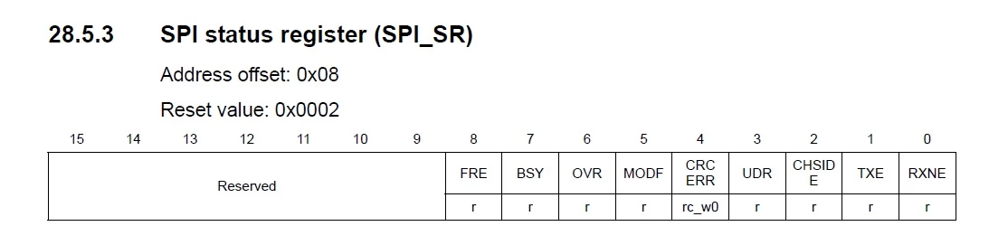

    while((SPI3->SR & SPI_SR_BSY) == 1)  //Test until Busy flag is 0
    Um, SPI_SR_BSY is 0x80, not 0x01.

    That == 1 is not the right test for the bit mask chosen, != 0 would work
    Hum, what's this 0x80? It's address?

    You're doing a bit wise AND so 0x40 & 0x80 = 0, so a comparison with 0 or not 0 will work
    0x80 & 0x80 = 0x80
    It is a bit in a register, ie bit 7, or (1 << 7)

    Right, had completely forgot , thanks Clive and Vangelis!
    Late night edit:
    Went back to SPI and spoked around a bit more why
    while((SPI3->SR & SPI_SR_BSY) !=0) {}  //Test BSY if it's 1, if 0 then exit test.
    didnt work and pondered if there is some kind of delay issues with BSY
    (errata talks about sync issues with internal buses) or the cpu is to quick
    to test BSY and sure enough 12 nop's is what it took to detect BSY.
