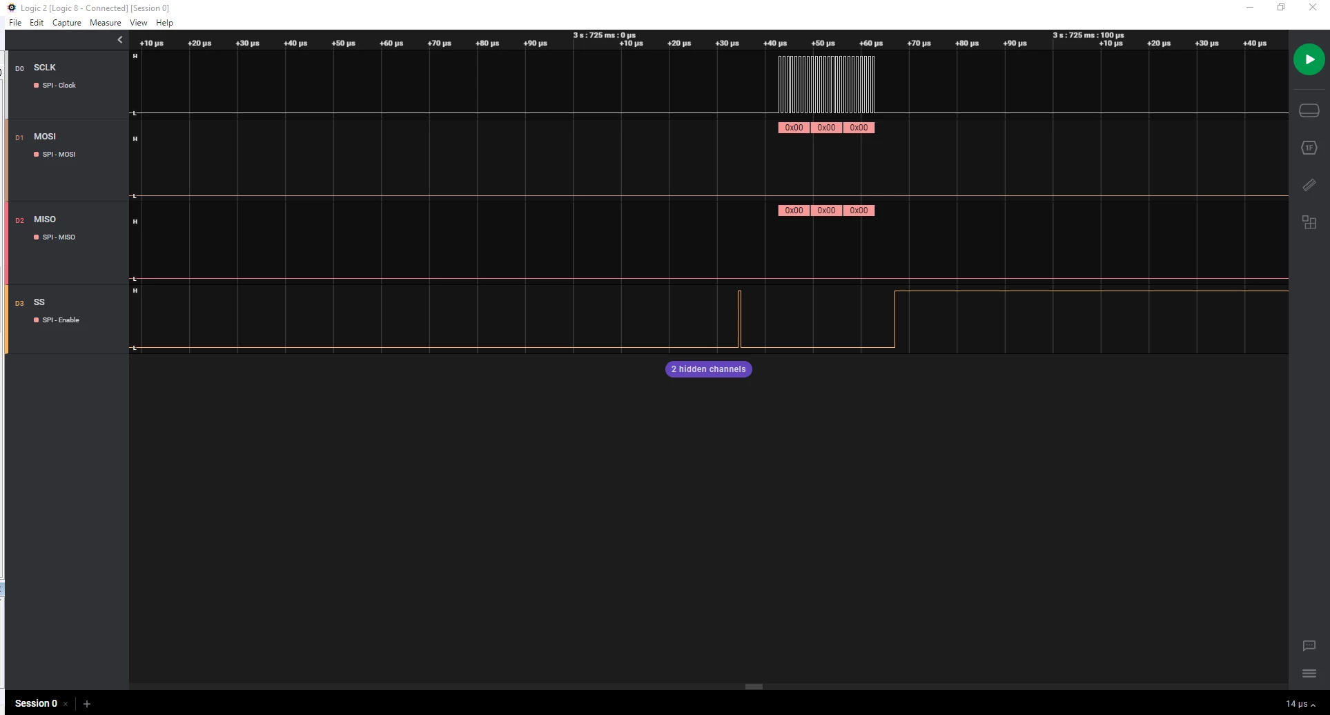

SPI buffer TXDR was written as 0x00 .
I'm developing SPI driver for Nucleo-H753ZI so Nucleo-H753ZI will be SPI master. It'll be connected to DAC which is slave. As of now I'm using STM32HAL drivers to configure Nucleo-H753ZI as a Master. After configuration I've tried to transmit buffer (having 3 elements). Still I've not added Slave code in master, instead I tried to scope in data sent through MOSI through a logic analyzer. I was seeing MOSI line value as 0x00. When I kept a break point in HAL_SPI_Transmit() function I'm able to observe that the data written to TXDR register is 0 eventhough the buffer is passed to HAL_SPI_Transmit() function? I'm wondering TXDR wasn't written with correct value? Can anyone help me on this?

 HAL_SPI_Transmit(&hspi1, (uint8_t*)Txbuf, 3, 100);
 HAL_GPIO_WritePin(GPIOA, GPIO_PIN_4, GPIO_PIN_SET);

I'm not sure the register is readable.
Double check the pin configuration in the MSP code file.
Double check you're probing the right pins, and they have end-to-end connectivity. Check the schematic for the board. It will be the equivalent to the NUCLEO-H743ZI2 model with the ST-LINK/V3 if I'm not mistaken.
Check pin designations, and solder bridge connectivities.
Pins involved not mentioned or shown in code.

naveen_kumarAuthorBest answer
January 13, 2023
I had connected to different SPI pin, I reconnected to correct pin, It was working.
Thanks Tesla.
