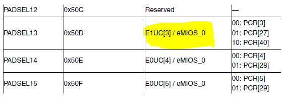

SPC560D30/40 family of mc IPM channel 3 as PB[11]
Iam using PB[11] - PB[15] as Input Pulse Measurement (IPM),
I am able to read IPM from PB[12] to PB[15] using Enhanced Modular IO Subsystem (eMIOS).
I am unable to read IPM using eMIOS-0 Channel 3 (using PB[11] as pin), Even I configured Pad Selection for Multiplexed Inputs Registers (PSMI0_3–PSMI60_63).
Here my question is?
Is it possible to use PB[11] as eMIOS-0 Channel 3 for IPM, because I am confused: For reference see the
following snap with highlight in yellow colour from RM0045 reference manual Table 158.
If yes Please help me how to configure
else, give me some justification.
Iam able to read PA[3] as eMIOS-0 Channel 3 for IPM, But I need it on PB[11]
