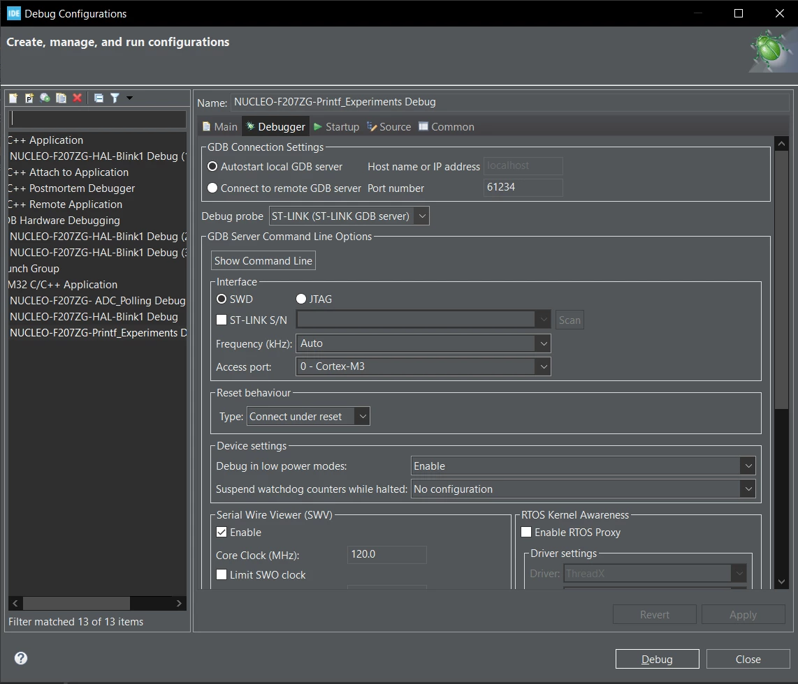

Which involves rewriting the write() function. I also tried this write function
int _write(int file, char *ptr, int len)
 int DataIdx;
 for(DataIdx=0; DataIdx<len; DataIdx++)
 ITM_SendChar(*ptr++);
 return len;

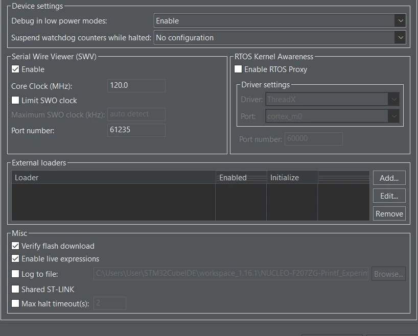

My debugger is shutting down (RGB lights out) and sometimes has to be power cycled.

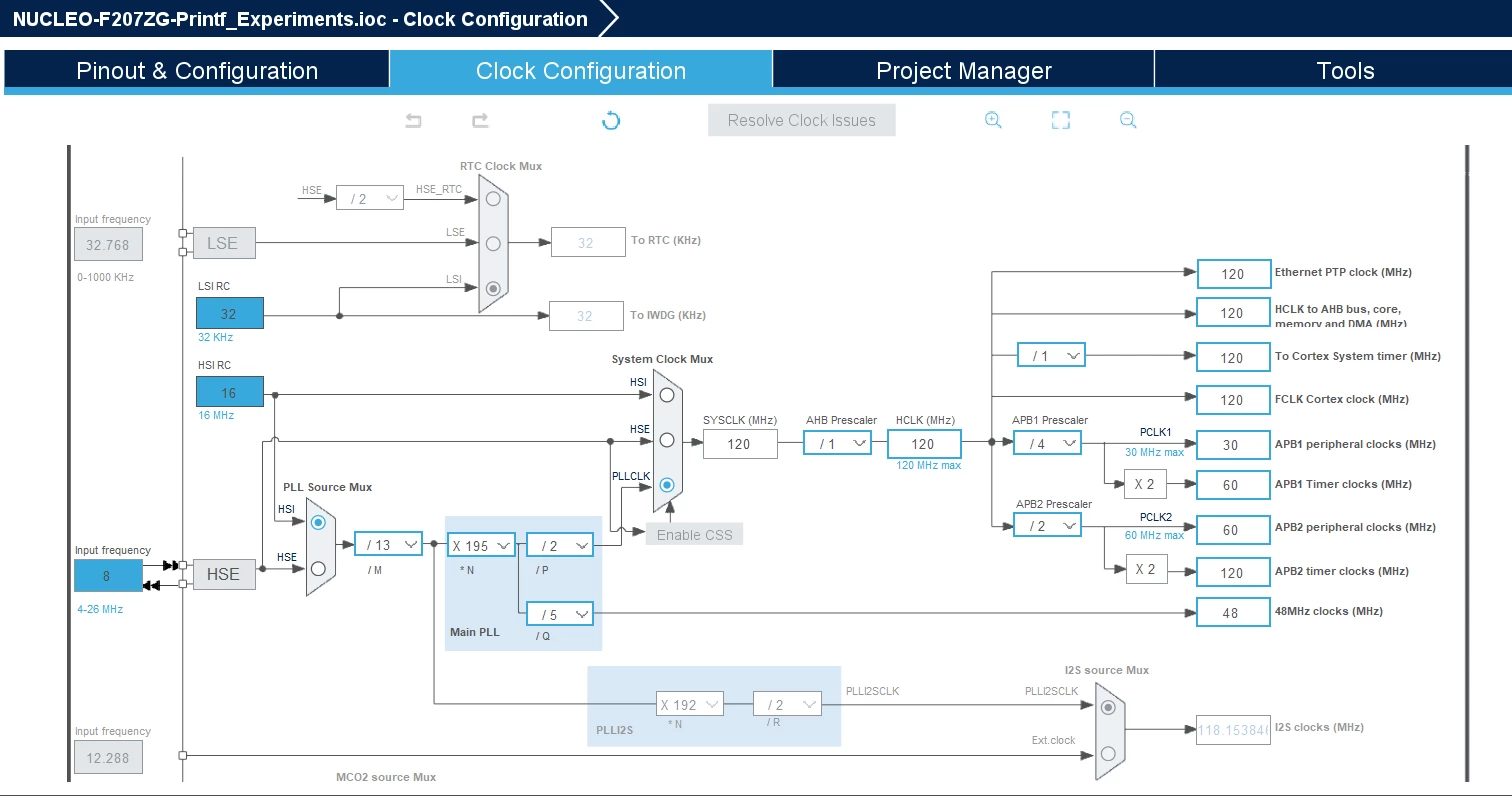

I have tried various core clock settings in the debug config tab.

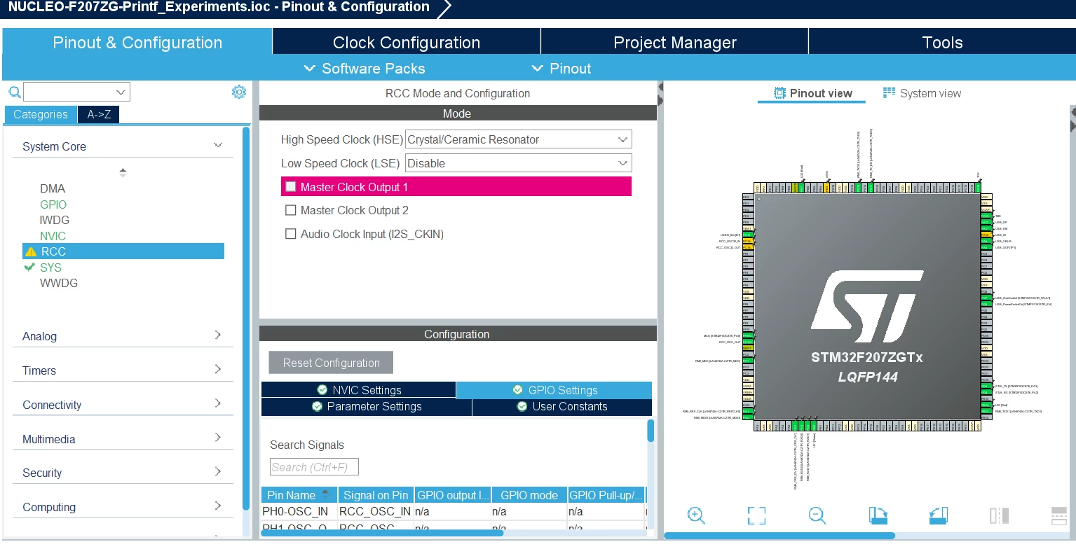

here are photos of the clock page, debug config and RCC options.
Thank you TeslaDelorian for trying to help in the previously hijacked thread. Here is my clock info.

The HSI as PLL source, when HSE is available, is strange... but well let's try.

Looks good. Now, to begin seeing SWO output in CubeIDE: after you start the program and it hits the first breakpoint in the debugger: click the red button in the SWO output. First time, the ITM setup dialog will open. Check the checkbox for port 0 (it is used for the prints). Do not change other fields for now. OK out of the dialogs and run.
November 19, 2024
Thanks for the reply.
I started the program (debug button) and hit the red/record button in various SWV outputs before continuing. Not SWO as I have set u for SWV through the ITM.
No blink and no data.
Sorry I do realise that I could have added more context. SWO does not work. All of this is because SWO does not seem to work.
https://www.reddit.com/r/embedded/comments/1bby3qt/the_definitive_guide_to_enabling_printf_on_an/?rdt=39922
Is this correct? I am using a Nucleo-F207ZG
I just want to print if you know a simple way to print using SWO please explain. It sounds like more complex code is needed (simple printf commands do not work).

I do not think in this thread or the references it mentions going to MX, System Core, SYS and setting debug to trace Asynchronous Sw. I have Timebase Source set to Systick which is default.
