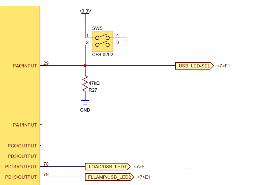

I am doing a project on STM32F479ZGT6. I set all my pins to HIGH default, open drain, external pull up on STMCubeMX. During power on, the IO pins first follows 3.3V by the external pull up, but then two of the IO pins becomes LOW during reset release, and then after reset is completely released, it turns back to HIGH(default logic set in STMCubeMX). Does STM32 has the ability to change logic opposite from the default logic only for a moment?(which in my case is during reset release) Would be glad to know any possible cause and solution for this case.
Red: Reset
Blue &Green: IO pin
A.Q_3011Best answer

Thank you for the advice. I think I have found the cause.
In my circuit, the 2 GPIO pins are sharing with the same pins used for program updater. The function of the IO pins (normal operation mode) and the program updater LED pins (program updater mode) are selected by receiving input from DIPSW.
For example,
DIPSW ON: USB programmer mode, function as USB LED pin
DIPSW OFF: Normal operation mode, function as IO output(FLLAMP, LOAD)
After STM32 reset release, it will run program updater first as far as I know.
  1. Power on
  2. CPU reset
  3. CPU release
  4. Run bootloader
  5. Enter program updater mode, to check USB presence. If not, run main program.
The sudden LOW is the logic programmed in program updater. But because I set the DIPSW to normal operation mode, and no USB detected, it breaks from the program updater code and run the main program. Because the default logic of the IO pin in main program is HIGH, it turns LOW→HIGH as shown in the waveform. So, apparently because the general IO pins and program updater pins are used on the same pin, the default logic of IO pin will change if the default logic for program updater and main program is different.
So, in order to solve this, set both program updater logic and main program logic to the same logic to prevent irrelevant logic change during startup.

Ahh, so the problem is the pin is getting pulled low at/during startup. Which pins are these? Are you setting the state to high before you make them an output? Does it happen if you leave the pin as input?

You can state WHICH TWO PINS of STM32F479ZGT6, and then let’s check the DS&RM.
Some specific alternate functions related, maybe.

In particular, as the others have said, you need to state which pins you’re looking at.
Also, show the schematic.
