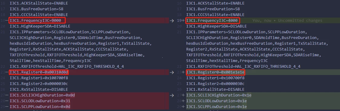

Hi,I am working with  STM32H5RBT6U:

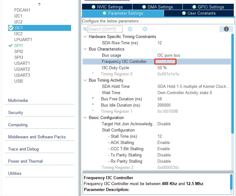

How do I calculate the frequency of the I3C Controller? Is there documentation to cover the content?

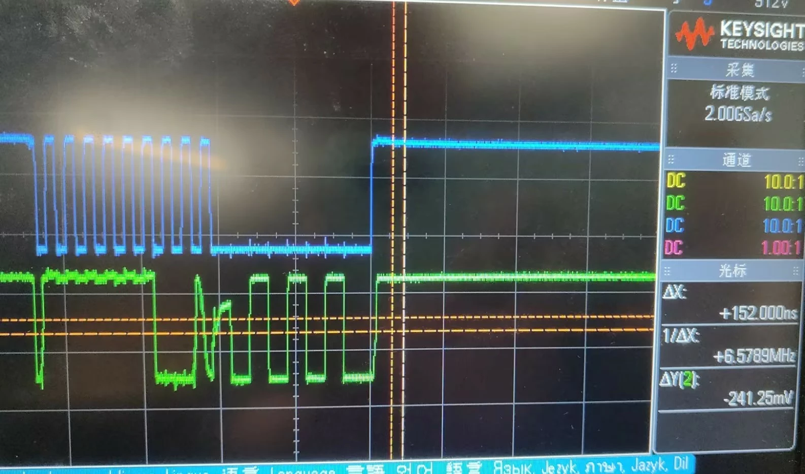

I tried using CubeMX to set the frequency, but strangely, all the frequencies work fine except 3~5MHz.
The exception is that at this rate setting, the controller can only send out the reserved byte waveform, and subsequent clock signals will not be generated normally

hello,
Q1:Why is the minimum recommended SDA rise time 350ns? Why do I set 12ns only affect the frequency of 3~5M, which is smaller or higher, why is there no effect?
This SDA rise time is the value measure of SDA rise time, between GND to 70%VDD, capacitor effect.
This timing is important for Controller to detect correctly the SDA high level.
Concerning the frequency issue that you have detect, i think it is frequency out of 3Mhz, mean 12.5Mhz should not works properly too. At those frequency you are at the limit a correct Controller detection with the wrong value of SDA rise time.

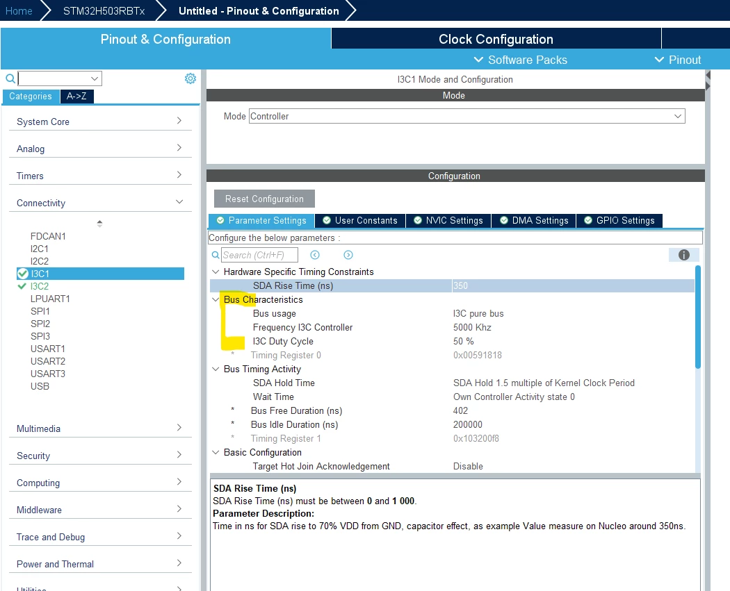

Dear,
To start better on I3C on H5, prefer modifying only this part of CubeMX at first usage on your side (parameter under yellow highlight):
for example, it seems that you modified the default value of SDA rise time, which can be a critical value if not well set. For the STM32H503 nucleo, it is preferable to keep at minimum the value 350, as suggest in the parameter description.

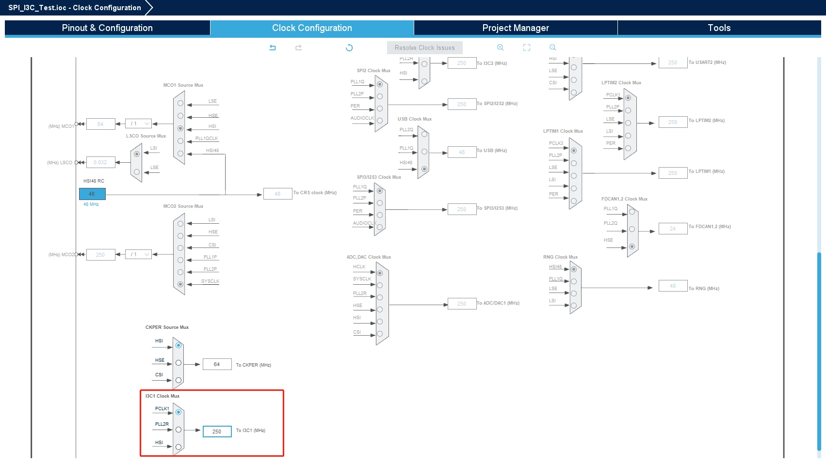

One question or confirmation, for you, what is the clock source frequency of the I3C in your case ? 250Mhz ?

A1:Yes, the clock source frequency of the I3C in my case is 250M。
