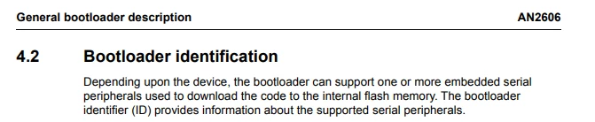

From AN2606:
So the different IDs distinguish different hardware connections.
You will choose the hardware connections as part of your hardware design, so that determines which Bootloader ID will apply to that particular design.
