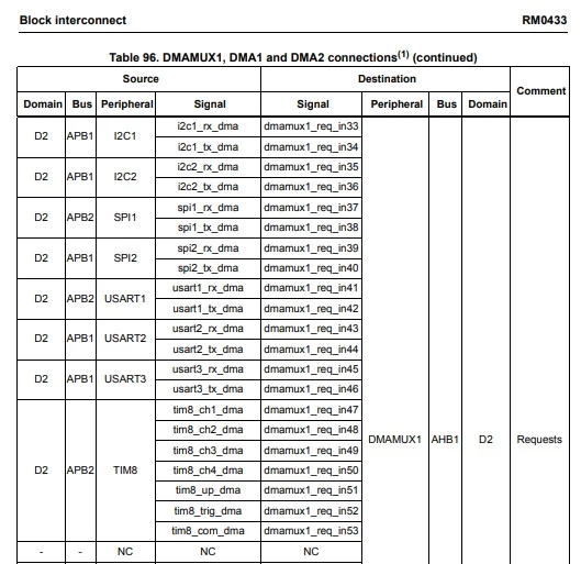

Apr 19, 2019 2:22 PM UTC
it has this;
I want to use the SAI controller to read data from the AD7768 adc, so im looking at the sai1a_dma, and i can see its on the 87th mux input.
and also another list, but i cant make much practical sence of it.
On the f4 you have a clear table with each channel and stream, but i cant find anything like that of the h7.

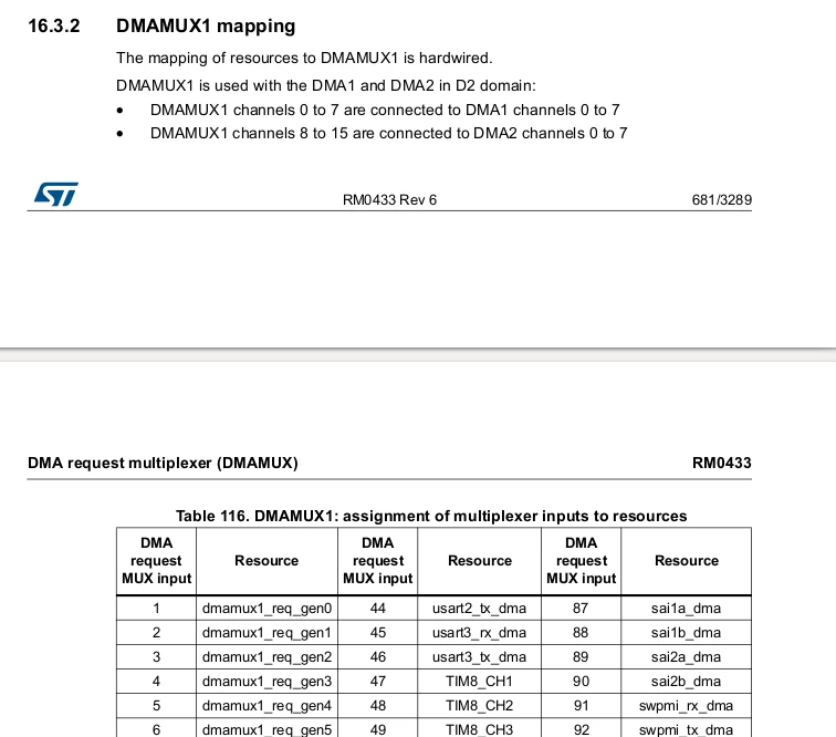

Apr 19, 2019 2:29 PM UTC
Yes, i saw this list, and i saw that the sai1a_dma is on signal 87 of the dma mux, but to which channel does that translate?

waclawek.jan
Apr 19, 2019 5:33 PM UTC
To which you assign it in DMAMUX. That's what DMAMUX is for.
If you don't want any of the fancy stuff, simply write 87 into say DMAMUX1_C0CR.DMAREQ_ID, and then your SAI_A DMA triggers stream 0 of DMA1.
