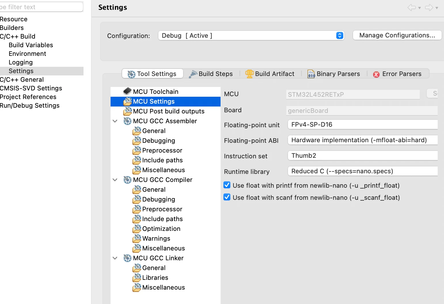

The problem is about Sprintf with floating point number on STM32L452RET6P.

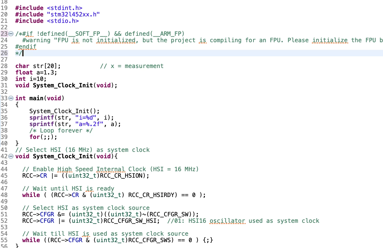

Although all settings are correct, sprintf doesn't work with floating point number only. Although it works on stm32cubeMX, it doesn't work on bare-metal program. It loops endlessly in the Default_Handler function. I'm about to go crazy.

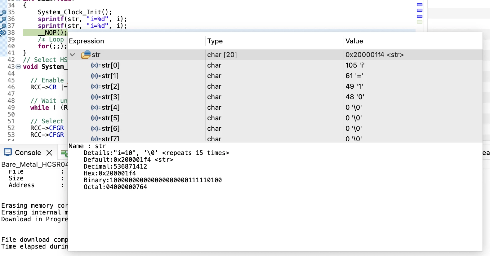

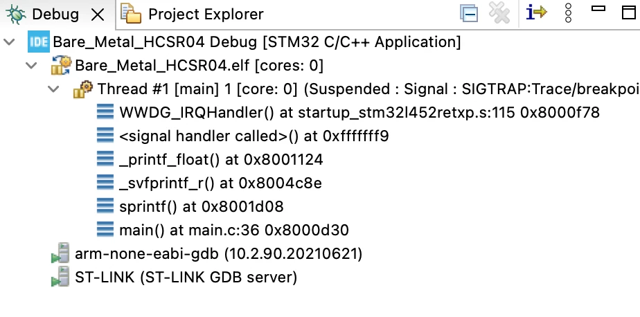

First sprintf properly works. But the second one does not. After second sprintf, I've traced back the code on the debugger and I can see that the DefaultHandler executes and traps the board in an Infinite_Loop as a result of WWDG_IRQHandler misfiring.
Error message tells me "No source available for "<signal handler called>() at 0xfffffff9" , No source available for "_printf_float() at 0x8001124", No source available for "_svfprintf_r() at 0x8004c8e", No source available for "sprintf() at 0x8001d08" . I can't seem to solve this problem, do you have any idea?
 Program is below:

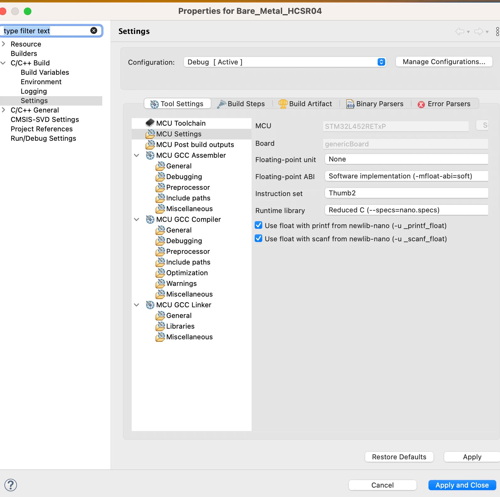

Here is linker flags.
 -mcpu=cortex-m4 -T"/Users/fatih/STM32CubeIDE/workspace_1.2.0/microprocessors/2023/Bare_Metal/Bare_Metal_HCSR04/STM32L452RETXP_FLASH.ld" --specs=nosys.specs -Wl,-Map="${BuildArtifactFileBaseName}.map" -Wl,--gc-sections -static --specs=nano.specs -mfpu=fpv4-sp-d16 -mfloat-abi=hard -mthumb -u _printf_float -Wl,--start-group -lc -lm -Wl,--end-group
Compiler Settings:
 -mcpu=cortex-m4 -std=gnu11 -DDEBUG -DSTM32L452RETxP -DSTM32L4 -DSTM32 -DSTM32L452xx -c -I../Inc -I"/Users/fatih/STM32CubeIDE/workspace_1.2.0/microprocessors/2023/Bare_Metal/Bare_Metal_HCSR04/Drivers/CMSIS/Core/Include" -I"/Users/fatih/STM32CubeIDE/workspace_1.2.0/microprocessors/2023/Bare_Metal/Bare_Metal_HCSR04/Drivers/CMSIS/Device/ST/STM32L4xx/Include" -O0 -ffunction-sections -fdata-sections -Wall -fstack-usage -fcyclomatic-complexity --specs=nano.specs -mfpu=fpv4-sp-d16 -mfloat-abi=hard -mthumb
Here's a screenshot of the debug window.

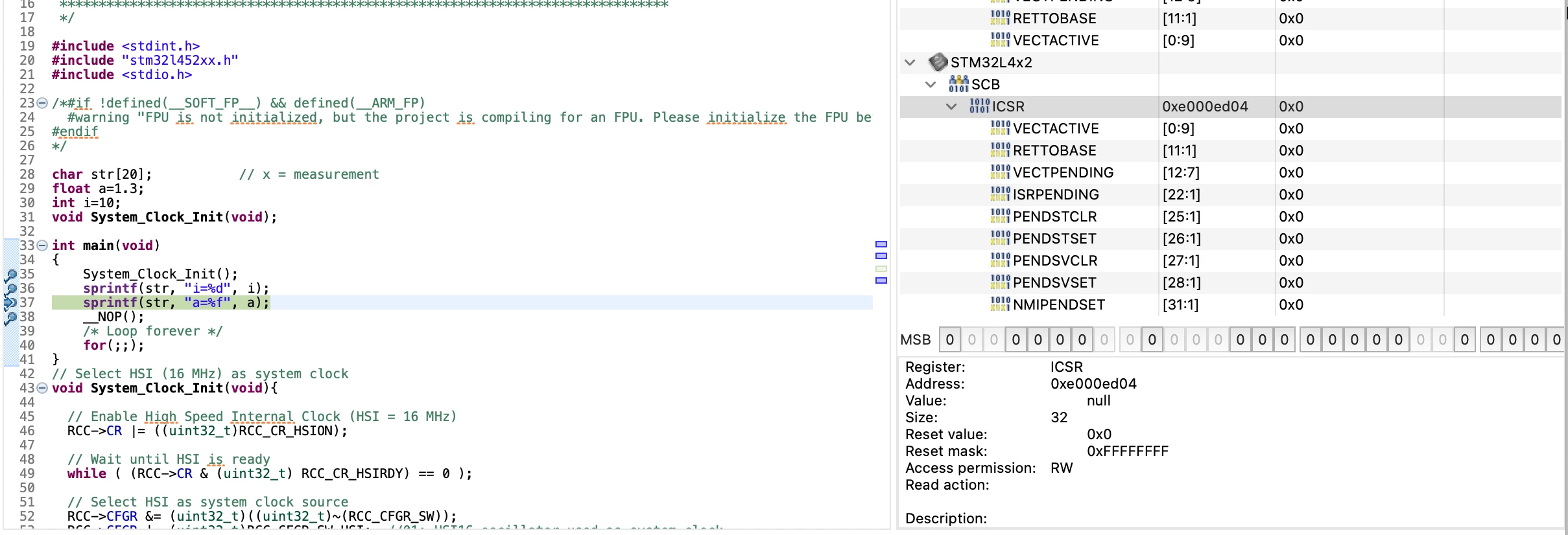

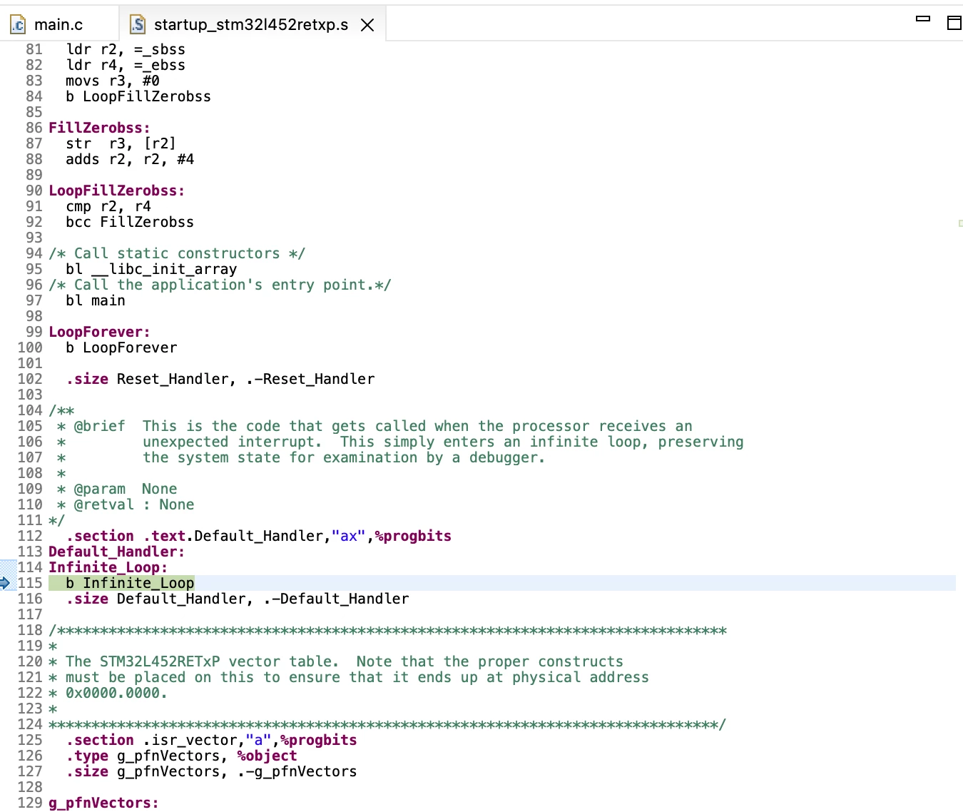

    Maybe this has nothing to do with printf() as such, and it ends up in default signal handler because of unhandled interrupt?
    What's the content of SCB->ICSR register at that moment?

    I couldnt understand why same program in stm32cubemx works properly.
    Before:
    _legacyfs_online_stmicro_images_0693W00000dJvzeQAC.pngAfter:
    HA.5

    repeat the first sprintf after the first one and comment out the second and see if it works.
    i mean like that:
    sprintf(str, "i=%d", i);

    when I disable FPU, it works:)
    waclawek.jan
    June 2, 2023

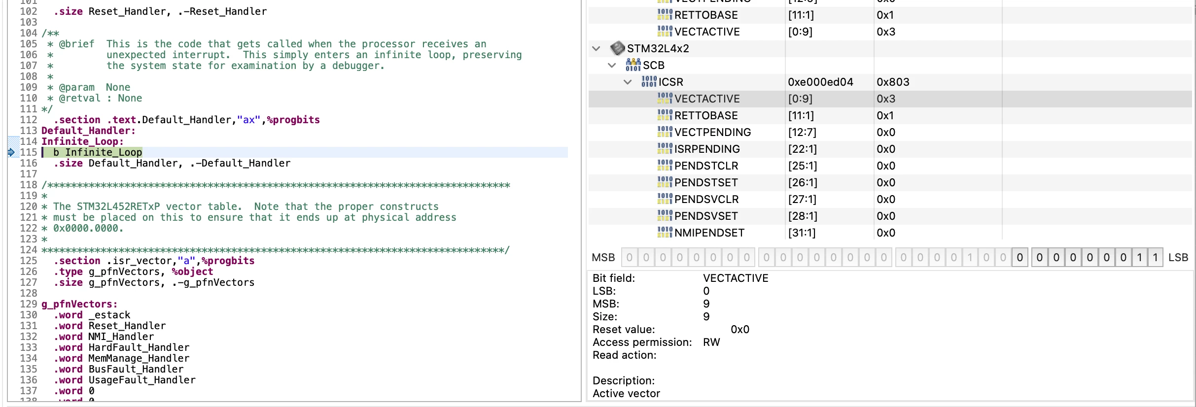

    Okay so VECTACTIVE is 3, which is HardFault.
    That would then point to FPU not being switched on in the startup code.
    I don't know how this is accomplished through the magic of IDEs - maybe it selects a different startup source file (.s)? Snippet of startup file I see in the screenshot above doesn't look like there is any code (conditional or function call) to do that.

    June 2, 2023
    Typically done in SystemInit() from system_stm32l4xx
    void SystemInit(void)
     /* FPU settings ------------------------------------------------------------*/
     #if (__FPU_PRESENT == 1) && (__FPU_USED == 1)
     SCB->CPACR |= ((3UL << 20U)|(3UL << 22U)); /* set CP10 and CP11 Full Access */
     #endif
    .c

    Thanks, you are great one!
    waclawek.jan
    June 3, 2023
    I don't see call to SystemInit() in that screenshot with startup code either, but whatever, if it works. I don't really about the magics in IDEs to do these things.
    Please select Tesla's post as Best, so that the thread is marked as solved.
