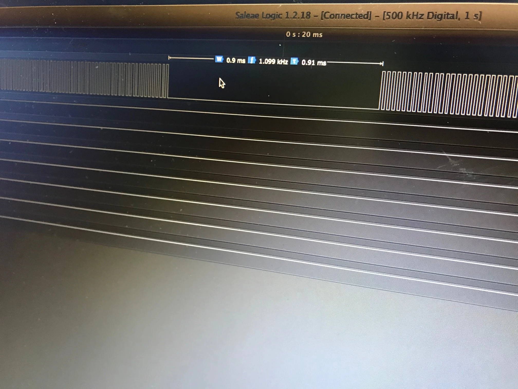

My issue is: When modulating the frequency, I get random drop-outs on the PWM pin, from time to time the output drops to ground for a while. When the frequency is constant I get no drop outs. I tested with F103 and F411, same issue...
See output read by logic analyzer:

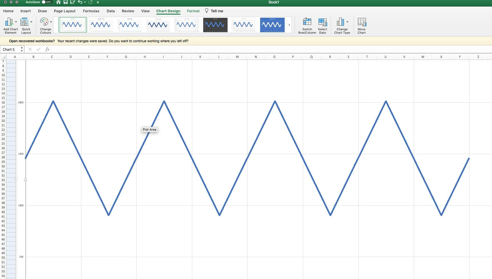

I am confident that my registers values for the timer are correct. I stored few periods in an array and plot them in excel:
So the issue is that I am changing the registers values over time. I am doing this with a frequency of about 1hz and the PWM frequencies are modulating from 35k to 80k. Where could it go wrong ?

    Look at the value of the registers when you get the "drop out". If you set ARR=0, the timer stops running. And if CCR1=0, then you don't get any PWM. My guess is one of those is happening.
    NT.3
    NT.3Author
    May 25, 2020 3:38 PM UTC
    I thought so too but I double checked and they never leave the range between 900 and 2012.
    May 25, 2020 4:27 PM UTC
    Could be an issue where ARR is updated first, then the code is busy doing something in an interrupt, then CCR1 is updated later. Disable interrupts while you're updating these two values.
    waclawek.jan
    May 25, 2020 5:15 PM UTC
    Is ARR preload enabled, i.e. is TIMx_CR1.ARPE=1?
    Are you sure CNT is always between 0 and ARR?
    Why do you change ARR at all?

    ARPE was not set! That was the problem, thanks!

    May 25, 2020 6:29 PM UTC
    Probably NOT random, change the settings at the UPDATE rather than some indeterminate phase of the counter
