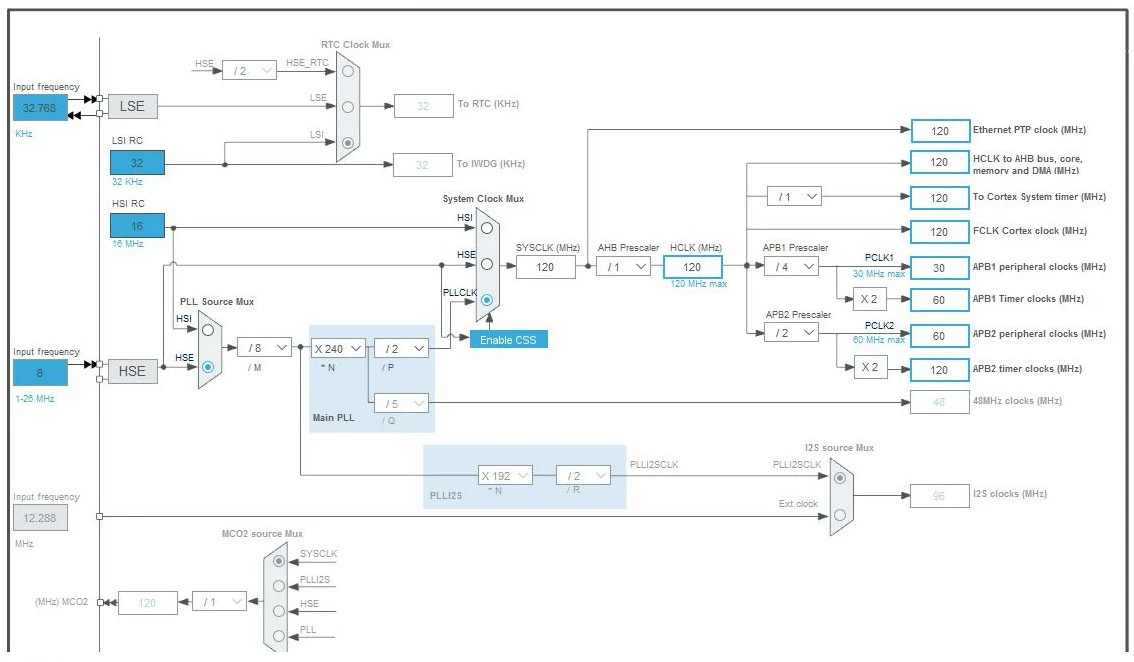

I need to perform some task without using HAL libraries. I am using CMSIS.
To start, I have set up a blinking led with timer.
I programmed the clock as per attached picture. The source clock of TIM6 should be 60 MHz but the led behaves as it were 30 MHz. It blinks at half the speed.
When I expect 500ms delay, the led stays on (or off) 1s. I don't' understand where this factor 2 comes from.
What am I doing wrong?
Here is the code

If in doubts, read out related registers' content and observe.
> RCC->PLLCFGR |= (PLL_M_SETTING << 0) | (PLL_N_SETTING << 6) | (PLL_P_SETTING << 16) | (RCC_PLLCFGR_PLLSRC_HSE);
The default value of RCC->PLLCFGR is not zero, so after this OR it contains something else than you assume.
Also make sure you change FLASH latency before you switch the system clock source.

@Community member​
well spotted! Thank you!
It works, now, after I added the lines
	RCC->PLLCFGR &= ~RCC_PLLCFGR_PLLM_Msk;
	RCC->PLLCFGR &= ~RCC_PLLCFGR_PLLN_Msk;
	RCC->PLLCFGR &= ~RCC_PLLCFGR_PLLP_Msk;

Did you have a look at the screenshot I attached?
If it is like you say, why the "APB1 timer clocks" is set to 60MHz, with APB1 prescaler set to 4 and not 2? The APB1 peripheral clock is 30, but the timer clocks is 60 Mhz. Why?
