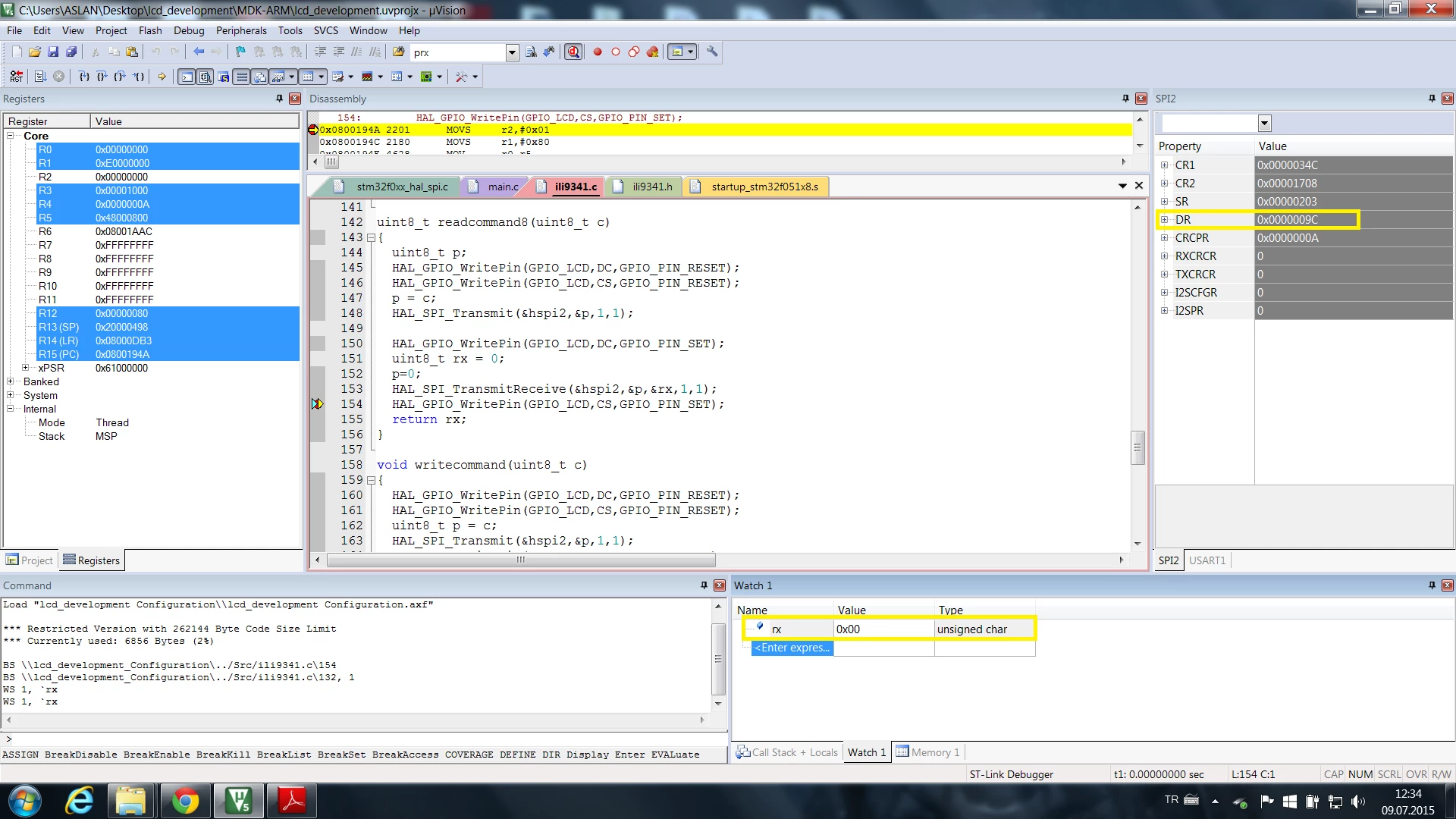

device stm32f0discovery stm32f051r8t6
even if I get SPI2->DR = 0x9C which is correct.I even look with saleae logic analyzer.HAL_SPI_TransmitReceive function does not write to rx variable I created.
Thanks for any help

    Posted on July 09, 2015 at 11:43
    http://3.bp.blogspot.com/-0ldzZ3RhGYQ/VZ5B3R8xIRI/AAAAAAAAABA/5HDXvRTDjlY/s1600/fail.png
    debug photo link uploaded with google blogger

    aaslan
    aaslanAuthor
    September 2, 2015
    Posted on September 02, 2015 at 08:08
    I did nothing.update of hal library 1.3.0 for stm32f0 solved my problem.
