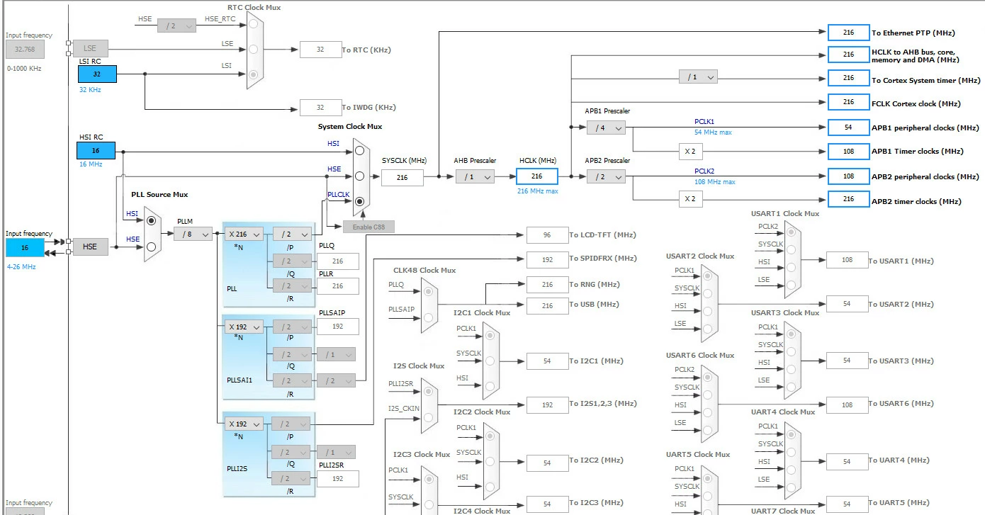

(SOLVED) Gap in performance between HSI & HSE ( Internal /External Clock )
I have a Nucleo STM32F767ZI with a X-Nucleo-PLC01A1 and a test application that cyclically switches ON/OFF the outputs .
All works fine when I use HSI, with Output LEDs that stay solid during ON state.
If I use High Speed Clock (in Cube MX, PCC->HSE->Crystal/Ceramic Resonator), LEDs blink with high freq, as a sort of refresh.
As you can see , I set both HSE & HSI to 16MHz, so working frequency are the same.
Can you help me or give me any suggestions?
This is HSI Clock:
while this is HSE:
Thanks and best regards,
Mario

By default that board is fed with 8 MHz external clock from ST-Link. If You haven't modified the board, then the correct code is:
RCC_OscInitStruct.HSEState = RCC_HSE_BYPASS;
RCC_OscInitStruct.PLL.PLLM = 4;

This is what Cube supposedly wants to do.
Have you checked what actually happens, like the pulse frequency on the ouputs, or the system clock frequency ?

The system appears as it is "slowed down", a "5s. delay" takes approx 10-11s.
It seems as a sort of prescaler was applied, but I'm no able to find where...
Code for HSE is:

Thanks!! It works!!
So, setting F7 HSE clock @16MHz caused a sort of erroneus clock syncronism, infact system took double time to execute code!
