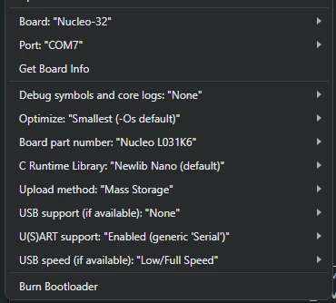

I use Arduino IDE and "STM32 MCU based boards" library to program Nucleo32. Here are the settings:

I reset it and it writes "Hi" in the Serial monitor, but when I begin() the software serial (line 8), nothing works anymore. Unable to toggle pins, no output appears in the Serial monitor and everything gets stuck.
When I remove line 8, it works without any problems.

Sounds like it faults the MCU.
Debug it, or engage with the Arduino developers.
Can you use a regular UART based serial port.
Check mySerial is not NULL.
