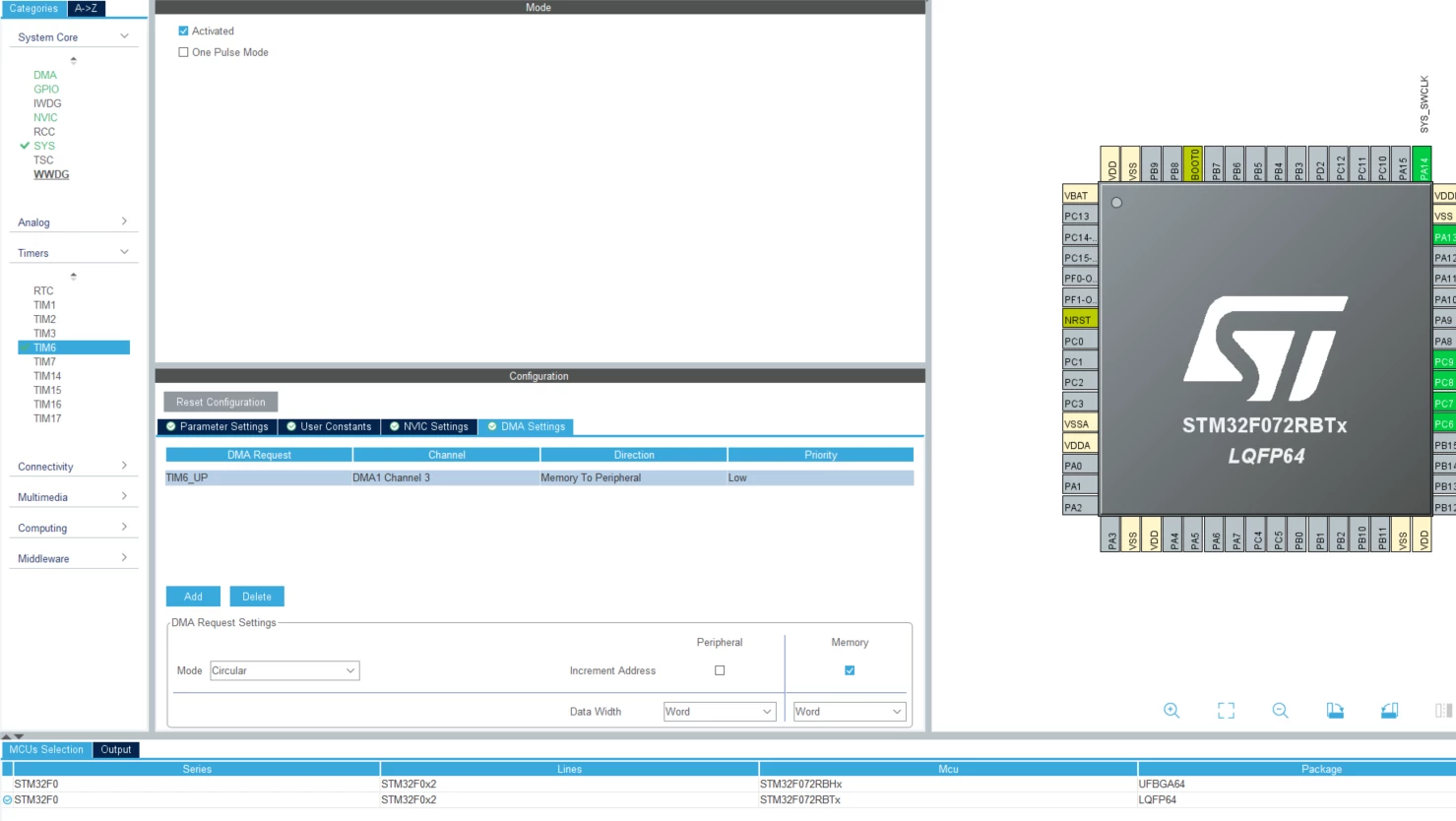

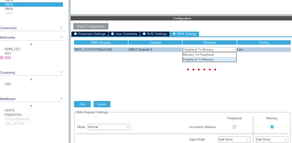

So im setting up a
uint32_t softpwm_values[100];
And i would like to use a (mem to mem) DMA channel in a circular mode with each transaction being triggered by a timer (timer freq= pwmfreq*100).
memory source is &softpwm_values (index increment) ,
memory dest is GPIOC->BSRR register
The problems i have now is:
  • How to trigger mem to mem DMA with a timer?, there is not a mem to mem available option
  • How to set the mem to mem DMA in Circular mode?, there is not circular mode available0693W00000BbmQAQAZ.png

waclawek.jan
Jun 23, 2021 11:42 AM UTC
No. The "direction" is quite misleading, it implies different variants of DMA behaviour of which "direction" is just one portion. M2M ignores the triggers. You want M2P.
I don't know how to click this in CubeMX. DMA is quite simple to set up normally by writing into DMA registers.

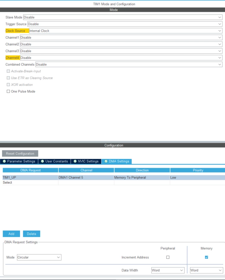

Jul 6, 2021 7:38 AM UTC
@Community member​
My best unssuccesfull attempt so far:
No dma is triggered, but tim_up interruptions are hapening
uint32_t data[100];
HAL_DMA_Start(&hdma_tim1_up, data, &(GPIOC->BSRR), sizeof(data));
Ill do some more clicks in cubeMX to see if i get somewhere

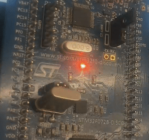

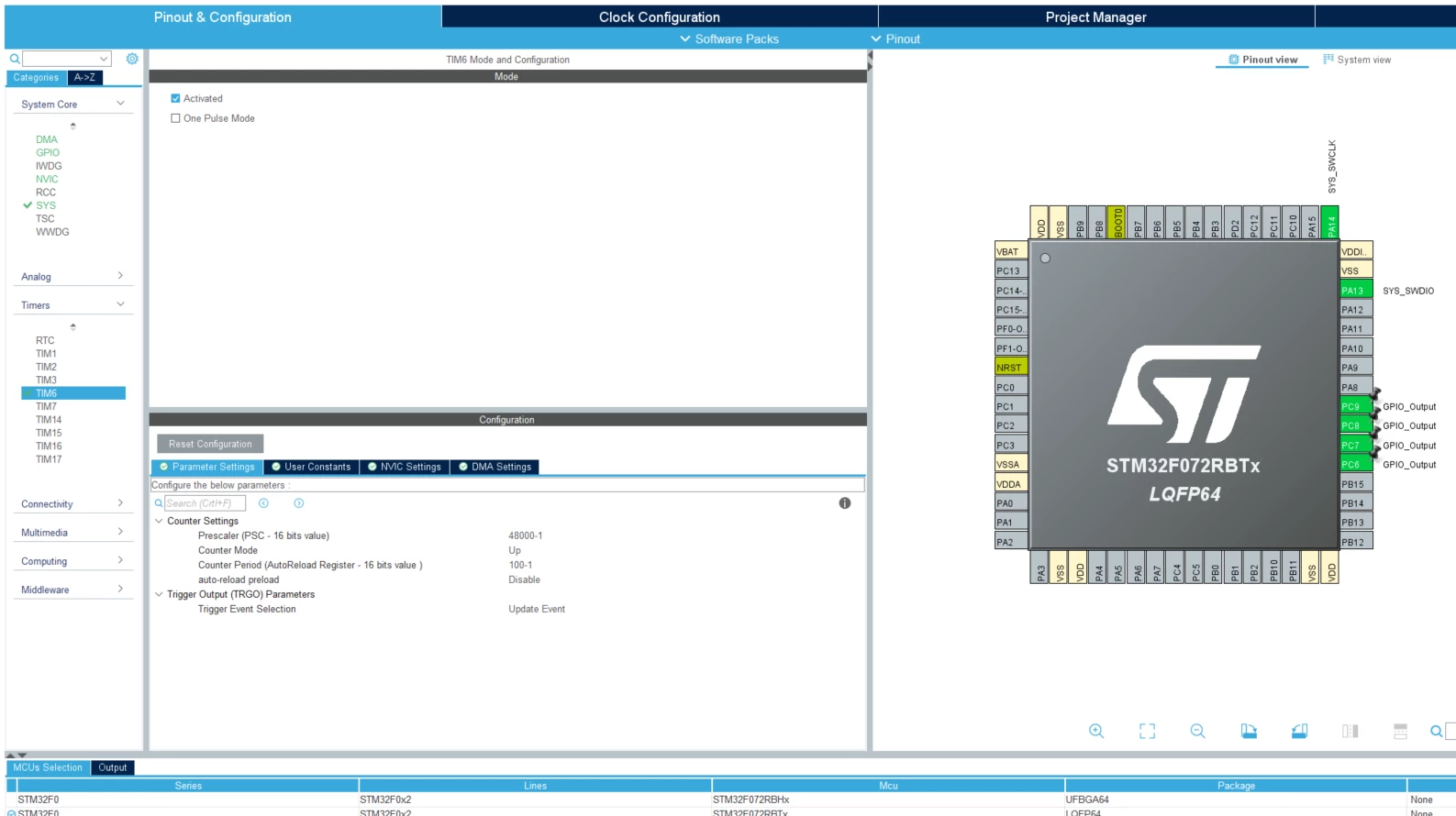

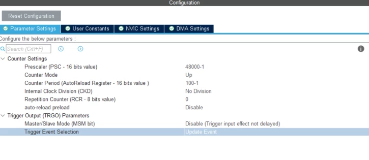

Javier1AuthorBest answer
Principal
Jul 6, 2021 9:23 AM UTC
@Community member​ thanks for your help.
0693W00000BcvCTQAZ.gifIt works now, i had some issues with choosing the incorrect timer/trigger and i didnt know this very important function
__HAL_TIM_ENABLE_DMA(&htim6, TIM_DMA_UPDATE);//https://metebalci.com/blog/stm32h7-gpio-toggling/
tim6 update trigering dma does the job for me.
/* USER CODE BEGIN PV */
uint32_t data[2]={GPIO_PIN_6,GPIO_PIN_6<<16};
/* USER CODE END PV */
/* USER CODE BEGIN 2 */
HAL_TIM_Base_Start(&htim6);
HAL_DMA_Start(&hdma_tim6_up, (uint32_t)&(data[0]), (uint32_t)&(GPIOC->BSRR), sizeof(data)/sizeof(data[0]));
 /* USER CODE END 2 */
