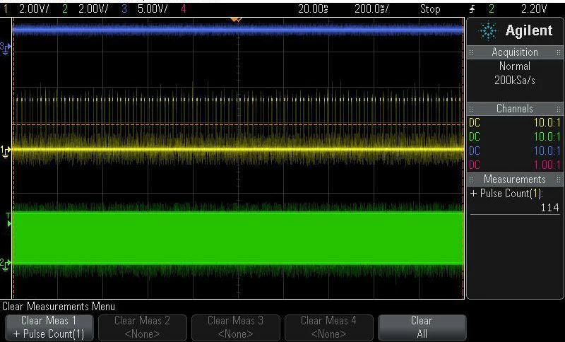

    this is the code to set pclk at 272khz(slow mode)
    CAMERA_IO_Write(DeviceAddr, 0xff, 0x01);
    CAMERA_IO_Write(DeviceAddr, 0x11, 0x20);

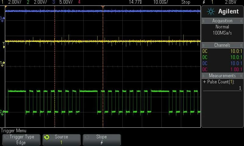

    the number of lines =114<120 lines 0690X00000603QgQAI.jpg Added to that the period of pclk isn't constant: 0690X00000603MzQAI.jpg Well,yellow color is for hsync signal,blue vsync and green for pclk signal .I wait for your support please :)

    Hi,this problem appears only when the resolution is QQVGA (160x120).Well for the resolution (320x240) the signals are right.Please i really need your help!!

    I would be more confident in this measure when the scope capture shows both edges of the VSync signal.
    Show us the capture that measures correctly the 240 lines in QVGA mode.
