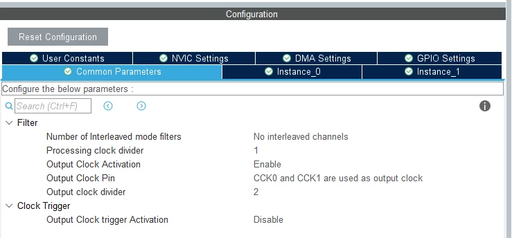

CKI0 and CKI1 can work simultaneously. However, make sure that both CKIx output are enabled:
1. In CKGCR register, make sure CCK0EN and CCK1EN are set
2. In CKCGR register, ensure CCK1DIR and CCK0DIR are set (pad direction is output mode)
If you have configure your project from CubeMX, in common parameters of MDF1, select "CCK0 and CCK1 are used as output clock" for Output clock Pin setting
Then, in MX_MDF1_Init, make sure you get the following configuration:
MdfHandle0.Init.CommonParam.OutputClock.Pins = MDF_OUTPUT_CLOCK_ALL;
In case you configuration in well done, please share with me your configuration and GPIO configuration.
