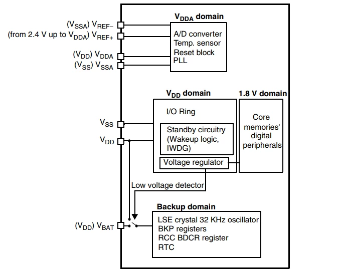

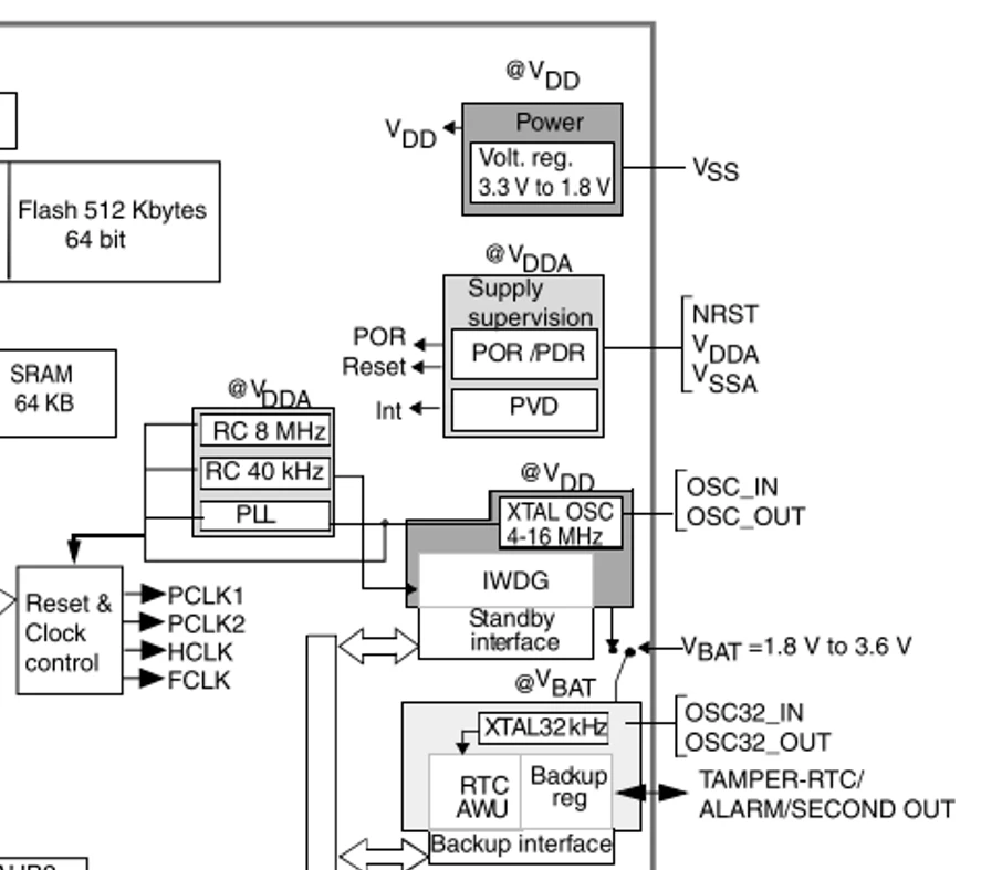

In Section 3.5.1 of the STM32F031 datasheet states:
The V
DDA
voltage level must be always greater or equal to the V
DD
voltage level and must be established first.
�The statement �
V
DD
