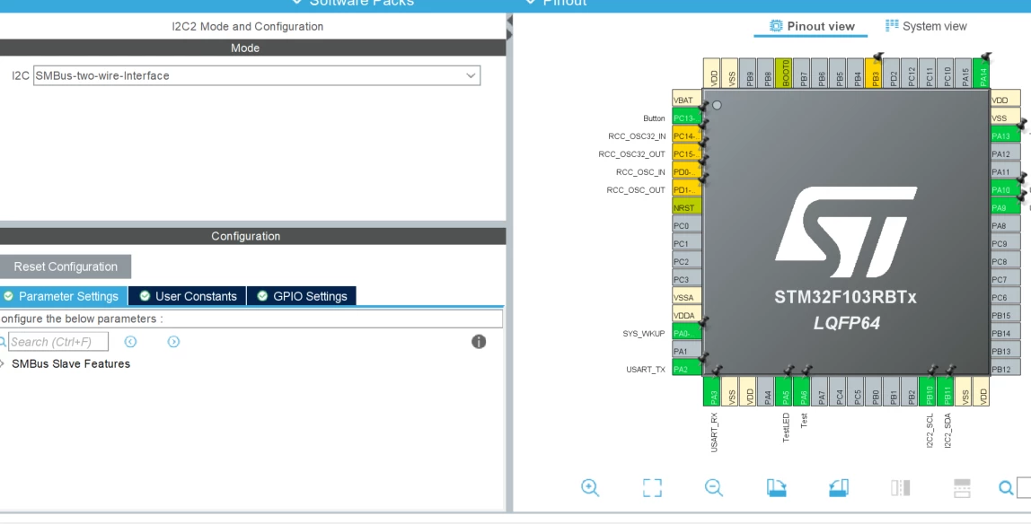

Could not find SMBus parameter setting MENU when I2C as a SMBus 2-wire mode.

Welcome @kim1, to the community!
Which version of STM32CubeMX or STM32CubeIDE are you using?
The parameters of the SMBus slave features should expand when you click the little triangle (or arrow) to the left of the line. You can also set only the primary slave address there.

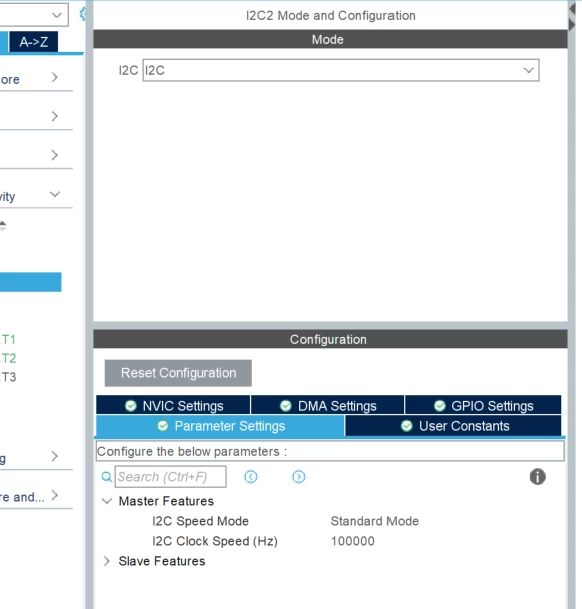

OK I know what you said.
I want to use I2C as SMBus master mode. but could not found any para. setting menu like I2C as I2C mode.

This is indeed interesting and should to be checked.

Hello All,
Thank you @kim1 for bringing this issue to our attention with detailed explanation.
Issue is reproduced and escalated to Development team in internal ticket ID163042 for fix.
