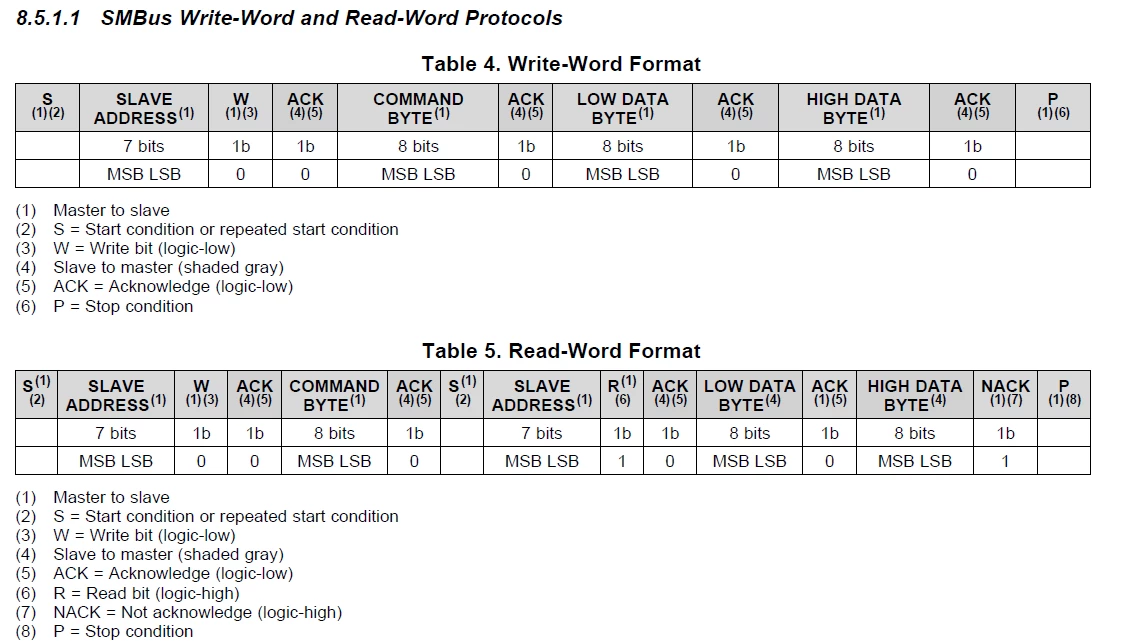

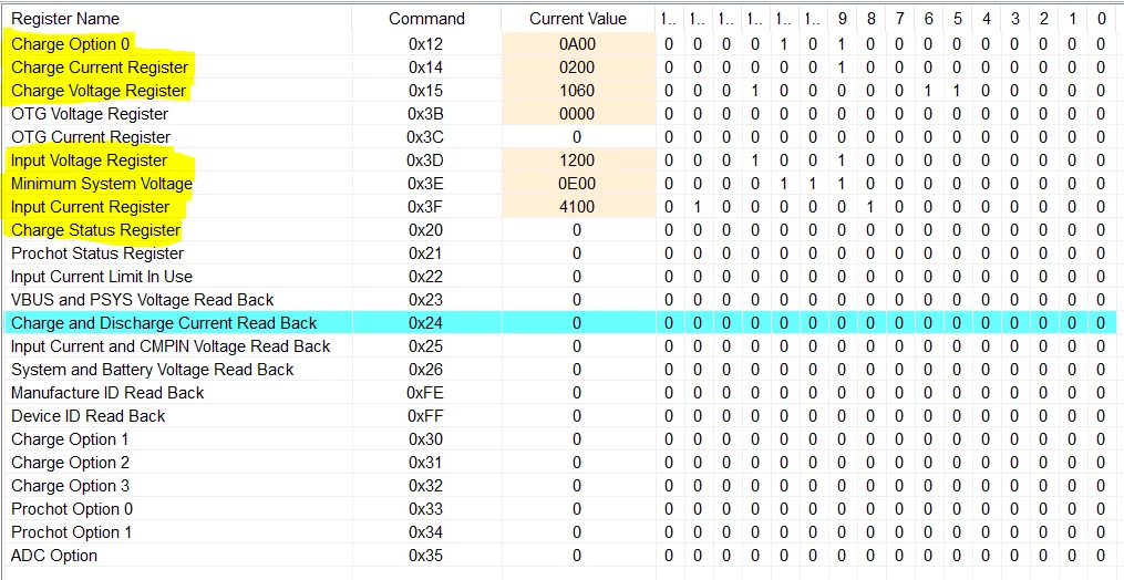

I am trying to do communication between Charger IC(BQ25700A) and STM32 controller by using I2C communication protocol.For taking the status of charging/discharging current of battery from charger ic,i have to configure registers in charger ic as shown below:
I am sending data packets as per the SMBus Write-Word protocol and receiving the data as per the SMBus Read-Word protocol. SMBus slave device with address 0b00010010 (0x12H)0690X00000BwUmUQAV.png
I have attached my c code,when i run the code getting zero value.Please give me your suggestions.
Datasheet of BQ25700A:  http://www.ti.com/lit/ds/symlink/bq25700a.pdf
