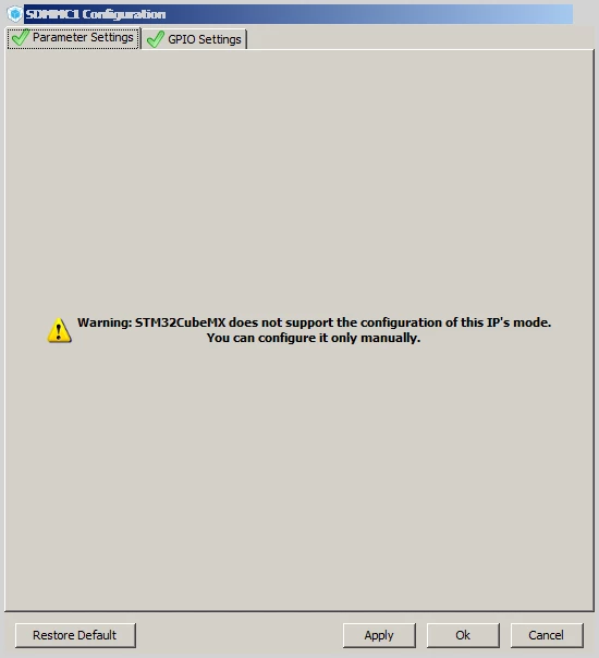

Hello there,
I am using STM32L452. I would like to interface with a SanDisk eMMC memory (
SDINBDG4-8G-XI1
In cubeMX, when I configure the project and choose SDMMC1->MMC 4 bits Wide bus, I get the following:
Does that mean that there is no ready HAL functions? Or, for instance, can I use the SD 4 bits Wide bus for communication? Are those interfaces compatible in STM32?

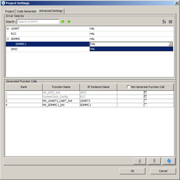

DAHMEN.IMEN
Also there is one thing not clear to me: For the L4 package i could find only the low layer MMC library, while F4 and F7 have HAL library. Are they compatible, or can I not use the HAL one for L4 device? This is additionally unclear, since in the cubeMX project options I cannot choose LL for eMMC but only HAL, which is not there...

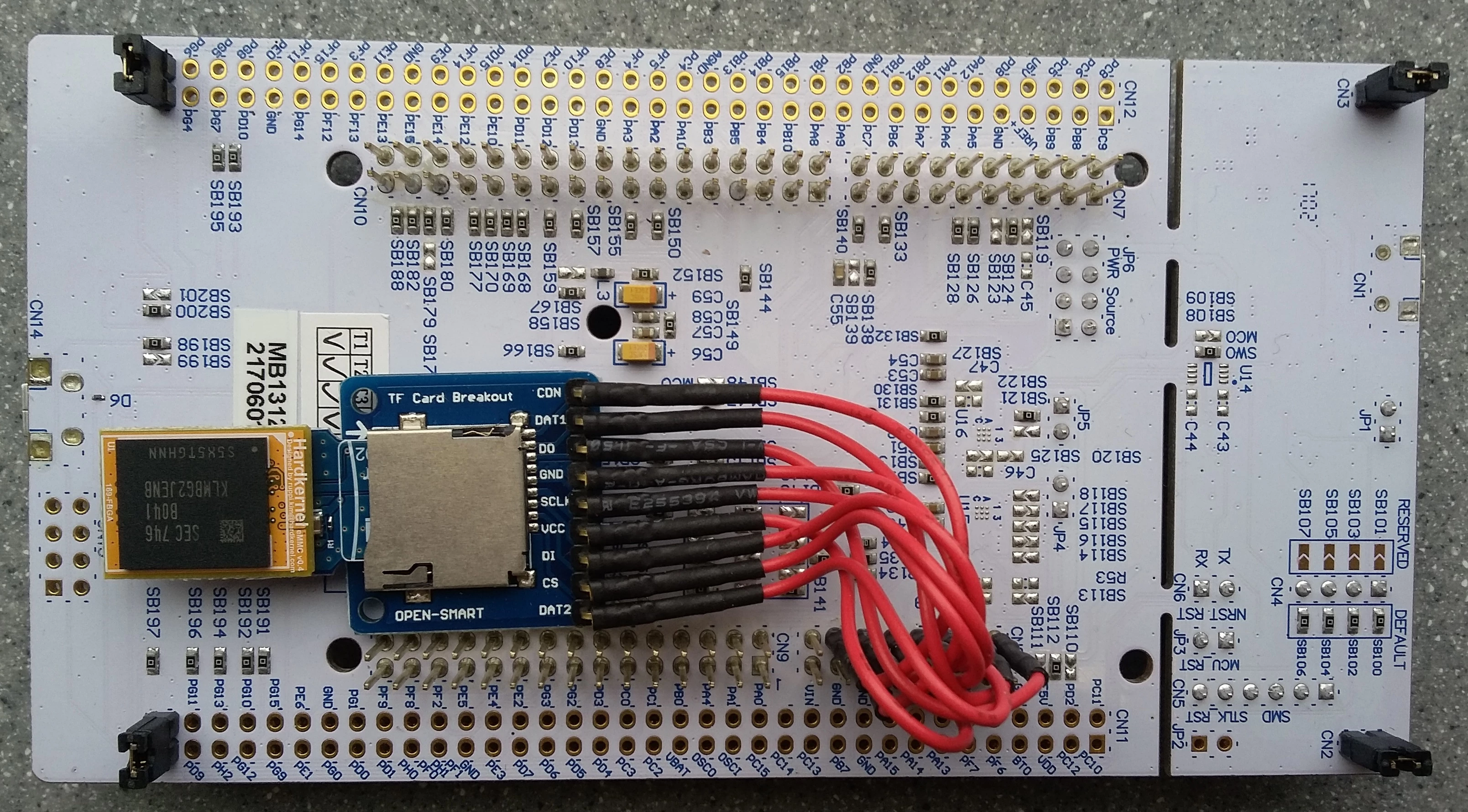

Ok, so making progress on this, I have eMMC running on L4 parts
Currently have builds working on L496ZG-NUCLEO, L4R5ZI-NUCLEO and STM32L4R9I-DISCO
Lukasz is tinkering with a 20-pin ''eMMC HAT'' that will plug onto the NUCLEO-144's SDMMC header

MMC configuration by CubeMX  is not supported for STM32L452 MCU. Also SDMMC is not supported by LL drivres.
Please do not hesitate to contact me for furthers details.
