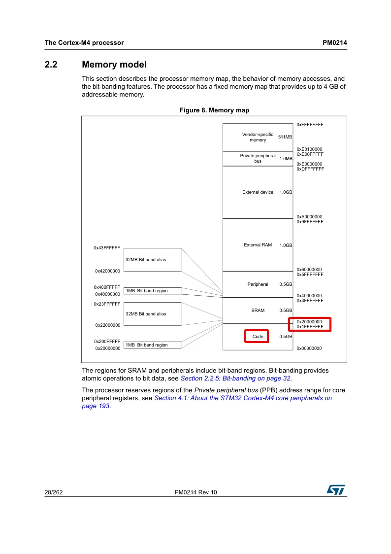

But the Cortex M4 reference manual says that the Code region, that can be accessed via ICode and DCode, end at 0x1000_0000... I still don't get it.
waclawek.jan
February 17, 2026
My copy of that manual says, that Code ends at 0x1FFF'FFFF:
(and the ARM manuals agree to this).
