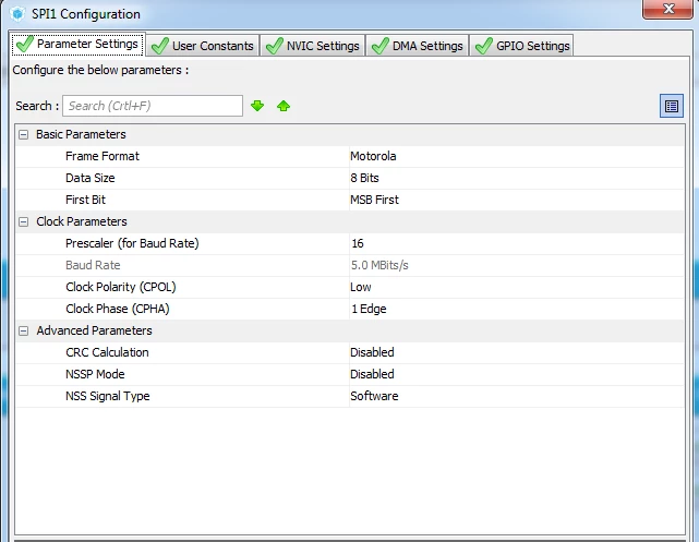

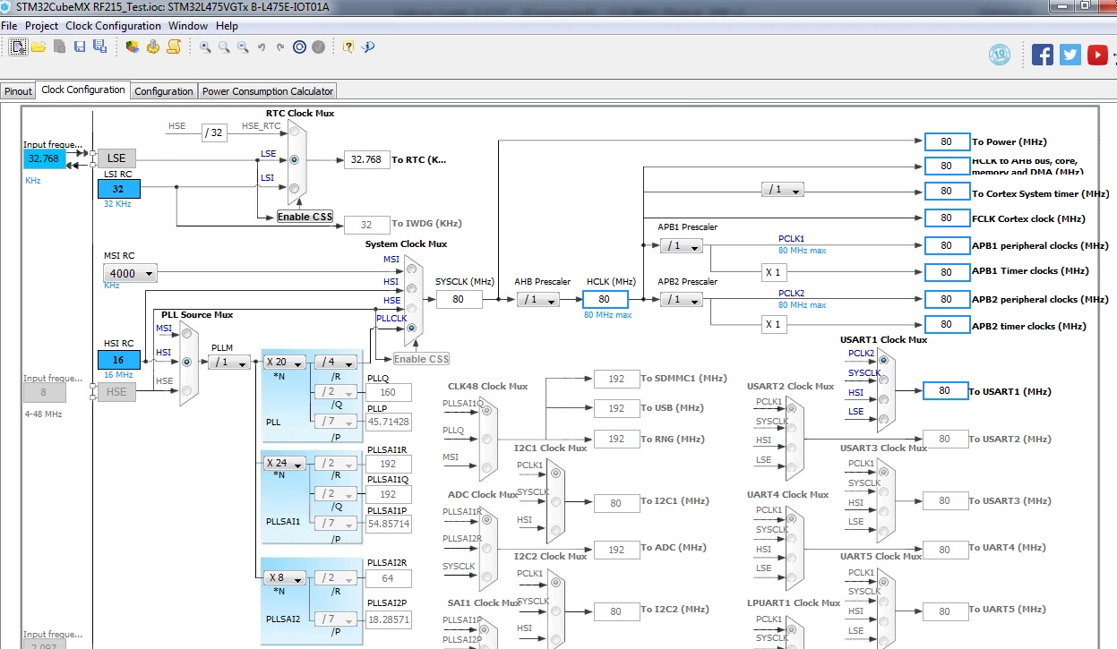

My clock settings
My SPI settings

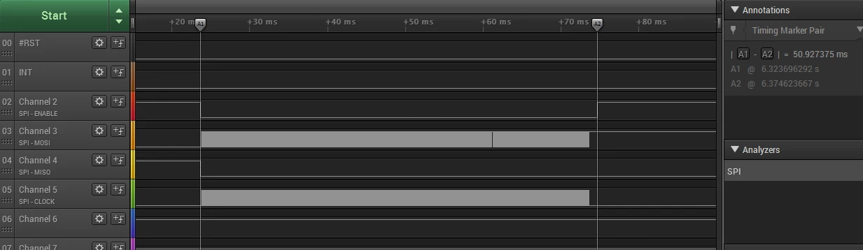

For write 1024 bytes need spend 50ms, data rate is 20KB too slow.

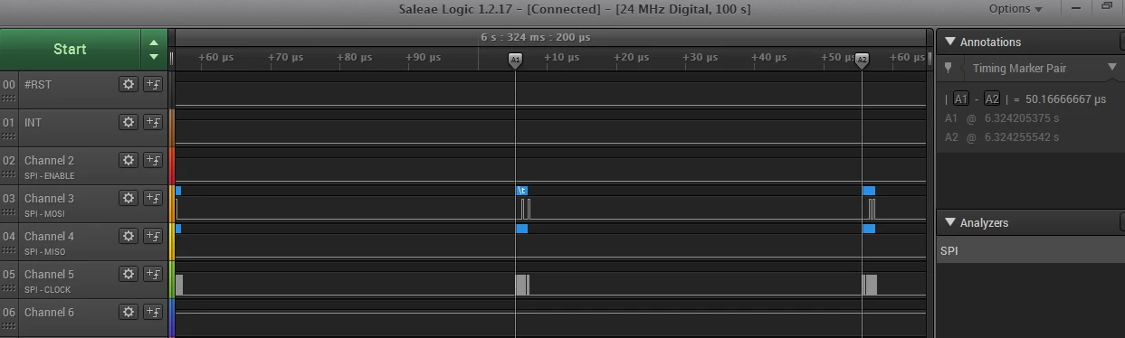

Period of byte writing is huge, around 51us

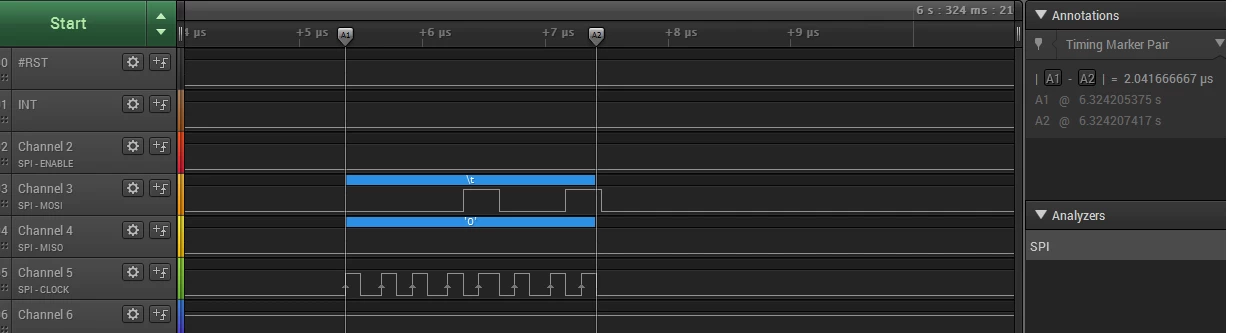

But for write single byte SPI spended only 2us. Other 49us we waste.
I don't understand why and what happens? Write function waiting only TXE flag. The TXE flag will be set when data moved from DR register to internal shifter. Main core works on 80MHz, one tick is around 12ns. Let's we spend 10 ticks for move data to shifter and set TXE flag it's 120ns but not 48us.
