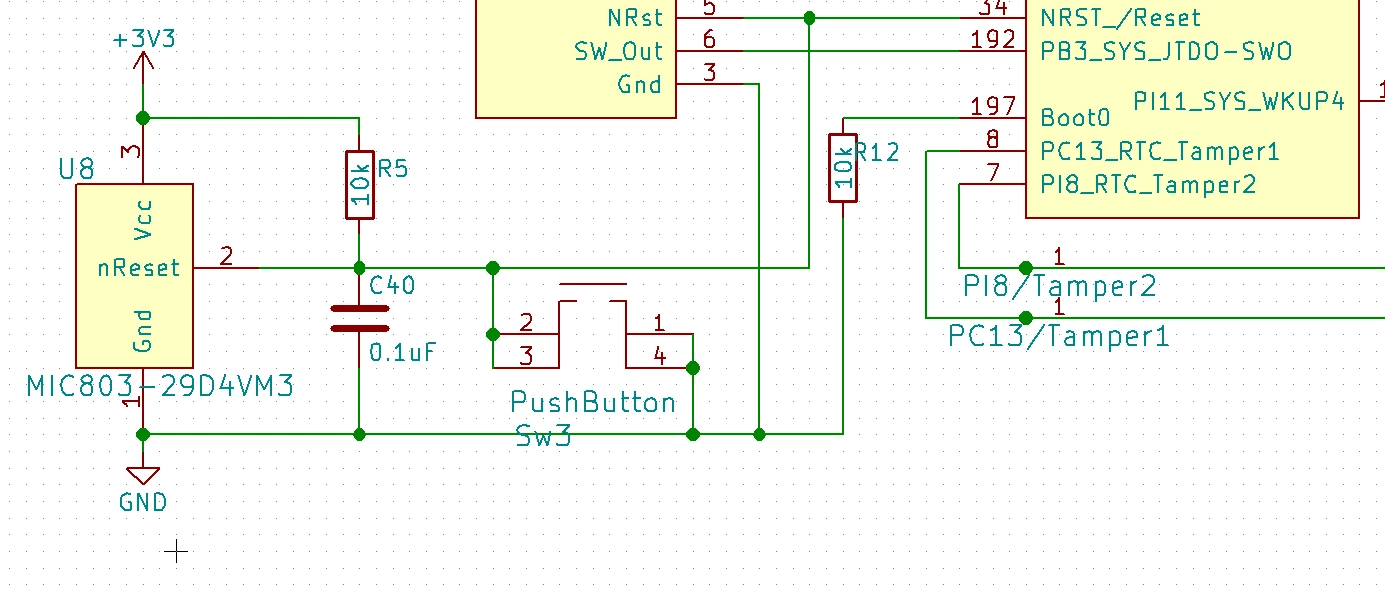

   I'm having an odd time with a board using the STM32F746VGT6 microcontroller that it requires that I reset the board each time that I power it up.  I have several of these and the phenomenon only occurs on about half of the boards.  When it does, it requires shorting the reset pin to ground as I don't have a reset button on this design.  I have checked solder joints of the 8MHz crystal and caps as well as the reset circuit (used from stm32f746 discovery board design).  The code is generated from CUBEMX.  It appears to run about 10 times as slow.  I'm trying to run the main PLL clock output at 192MHz.  Here is my startup code for the clock:

Tesla DeLorean
Guru
June 10, 2018
Posted on June 10, 2018 at 04:04
So probably 16 MHz HSI (so 12x slower)
Clear the auto/local variables
RCC_PeriphCLKInitTypeDef PeriphClkInitStruct = {0};
Surprised it wouldn't plough into the Error_Handler(), does that return?
Check your actually test the oscillator source __HAL_RCC_GET_PLL_OSCSOURCE()
Check define for HSE_TIMEOUT_VALUE
Check clocking of SysTick
Do you have a USART you can actually report internal status/functionality?
Have you quantified the time to start the HSE using some simple code to enable HSE via RCC, and waiting for HSE RDY. Compare/contrast between working/non-working examples.
Change the caps on oscillator see if that improves situation.
Quantify rise time of supply.

Is something precluding you from outputting some diagnostic information so you understand the state of the device?

if you have to use a reset chip,
this one works well  2.94V threshold and 1.2S delay.
Jeremy Vance
June 11, 2018
Posted on June 11, 2018 at 22:55
Thanks for the suggestion TJ.  I'll work it into the next design as a backup.  It can be unpopulated if I can figure this out otherwise.
