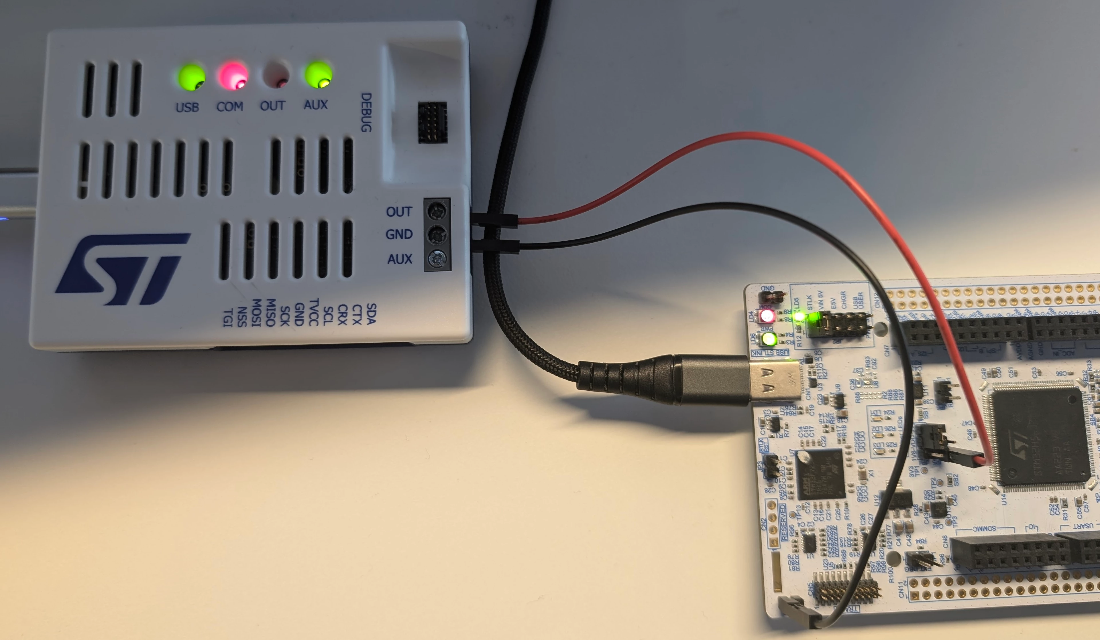

I have an issue with low power operation when using the USBPD library. We have successfully implemented a low power feature for our new product. After that we have started the development of a USBPD feature. The problem is, that after the function "USBPD_PreInitOs()" is called in main.c the power is much higher as it was before. As this function calls a static linked library, I have no idea what has been turned on and how to disable it again. Therefore I need your help as only you have the source code.
Here my simple steps to reproduce the problem:
Hardware (Nucleo144 STM32H563, STLINK-V3PWR):
1) In CubeMX I select the example USBPD_SNK, then I generate the code.

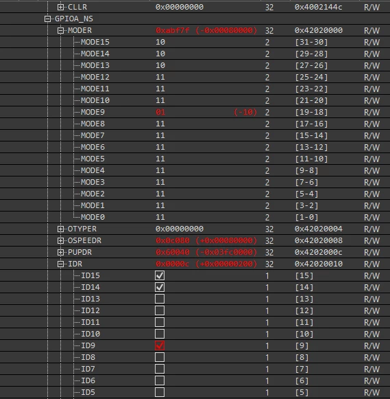

using reverse engineering I found the solution. I simply found out what function call is the problem, it was "USBPD_CAD_Init(..)". Then I scanned all HW registers that are changed.
So I found this:
It seems that a port pin changes its function. After turned the pin back to input mode, the current is as before.
Here my test code:
 /* Call PreOsInit function */
 USBPD_PreInitOs();
 /* USER CODE BEGIN 2 */
	__HAL_RCC_UCPD1_FORCE_RESET();
	__HAL_RCC_APB1_RELEASE_RESET();
	LL_GPIO_InitTypeDef GPIO_InitStruct = { 0 };
	GPIO_InitStruct.Pin = LL_GPIO_PIN_9;
	GPIO_InitStruct.Mode = LL_GPIO_MODE_INPUT;
	GPIO_InitStruct.Speed = LL_GPIO_SPEED_FREQ_LOW;
	GPIO_InitStruct.Pull = LL_GPIO_PULL_NO;
	LL_GPIO_Init(GPIOA, &GPIO_InitStruct);
	HAL_SuspendTick();
	HAL_PWR_EnterSTOPMode(PWR_LOWPOWERREGULATOR_ON, PWR_STOPENTRY_WFE);
