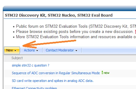

    Posted on June 18, 2014 at 17:13
    How to start a new thread
