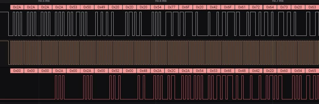

Simple SPI Echo Application drops receiving Bytes and sends undefined data (STM32G474RE)
I tried to impelement a simple SPI Echo Slave.
The Master transmits Data (Example for Nucleo 474RE - Master Full Duplex Interrupt) and the Slave waits for reception using HAL with a datasize of 1 Byte.
After the Transfer is completed I am copying the received Byte into the Buffer for the next TX Byte and waiting for the next Transfer again.
When receiving Data, every second Byte received gets dropped, and when trying to echo it, undefined data is sent.
0693W00000FCMYEQA5.jpgAs seen in the Image, the first Channel is MOSI, the second Channel is CLK, the third Channel is MISO. The Slave should transmit the identical message sent by the Master, starting with the second Byte.

How is this behaviour explained? And how to achieve the task?
Thank you very much.
Edit:
SPI is configured with Hardware CS, 8-bit Datasize. 170MHz on the Slave Peripheral Clock. Master uses 664kbit/s transmission Speed.
TDKBest answer
October 13, 2021
The slave needs more time to process the incoming data. Put a 1ms delay between bytes and it will likely work.
It's difficult to achieve this with SPI without restricting how the master sends data. One option is to set up the SPI in circular DMA mode and place outgoing bytes in the correct location as they come in. You will need to poll for new data quite frequently.
For this particular case, you could set up a 1-byte buffer in circular mode and use the same buffer for TX and RX, but that wouldn't be very useful in the long run.

Thanks for the fast answer.
For the sake of science, I tested it with a Circular 1 Byte DMA Buffer. Didn't work out either and caused the same behaviour :)
