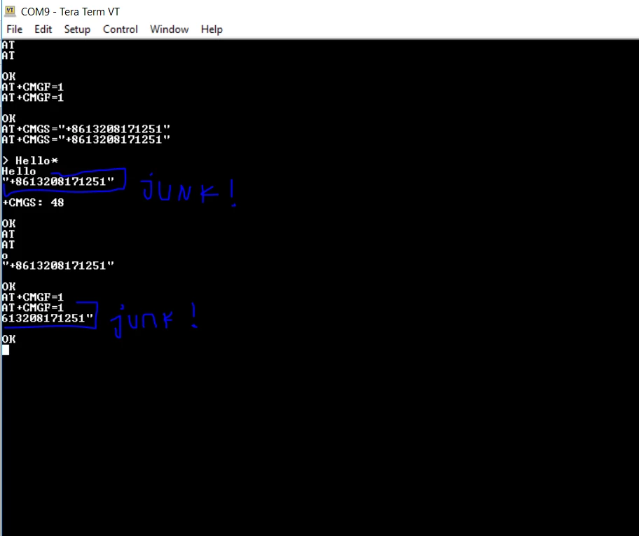

SIM900A GSM module with stm32f1
I'm trying to send message to sim900A via the serial port. The AT commands work but the GSM replies with some unwanted text (Previously sent text ) then finally OK. The GSM is supposed to reply what I typed with some prompts and finally OK. The picture below clearly tells what's happening. Is there any way to delete the data on the GSM buffer (If there is any) before sending a new one? 0690X00000989dUQAQ.png

if ( c == '*' )
recv[pos++] = 0x1A; // CTRL + Z
else
recv[pos++] = c;
// Echo back what you typed and save it in a buffer for later use
while((USART1->SR & USART_SR_TXE) == 0);
USART1->DR = c;
if ( c=='\r' )
recv[pos++] = '\n';
while(!(USART1->SR & USART_SR_TXE));
USART1->DR = '\n';
// Reset position for the next time
pos = 0;
} while(c != '\r');
    // Check is message has been completely stored in the recv buffer
    if ( c == '\r' ) GSMSend();
