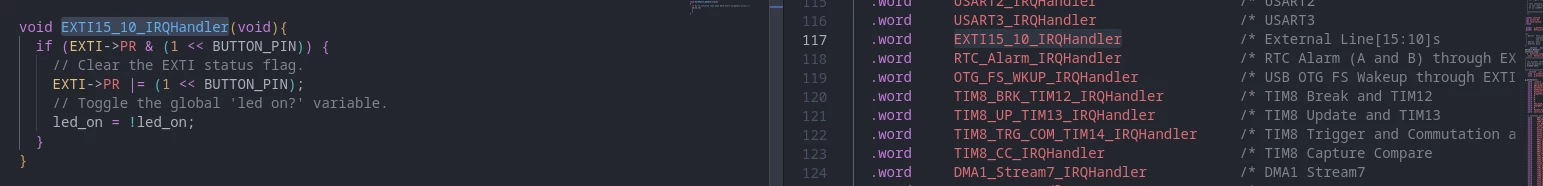

JFarr.4
JFarr.4Author
July 10, 2022
Hi Piranha,
Thank you for the excellent advice.
I definitely saw the matching of the names being an issue, so I did check that, but they line up, so it's something else :(
0693W00000QKneTQAT.pngAs for the PR register, my understanding was that the |= operator is a bitwise OR assignment, wouldn't that result in any existing 1s staying as 1s, and if 1 << 13 is a zero, it gets flipped to 1? Wouldn't an = assignment write 0x2000 to the register, disrupting the other bits?

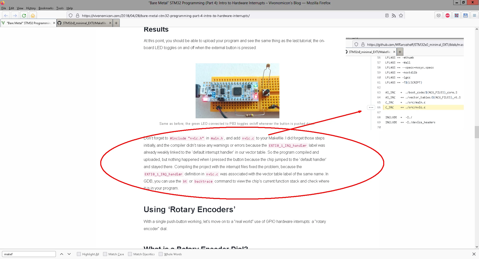

waclawek.jan
July 9, 2022
You don't compile/link nvic.c. Add it to the sources in makefile.

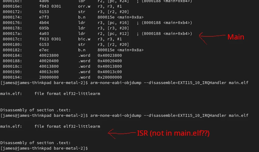

JFarr.4
JFarr.4Author
July 10, 2022
Hi JW,
Thanks for the advice. Could you go into a bit more detail about how this changes things from the M4s perspective? What would this look like in the makefile?
-James
EDIT:
While poking around in the assembly to see if my ISR was linking back to the main program properly, I found that the EXTI15_10_IRQHandler function wasn't making it into my main.elf:
0693W00000QKngoQAD.pngI'm guessing this has something to do with my linking/including errors you mentioned, is that right?
Thanks again for your help

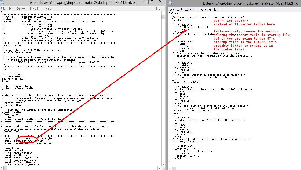

waclawek.jan
July 10, 2022
But as described there, as long as you don't explicitly define an ISR function in your code, the "weak" definition will prevail, and that leads to DefaultHandler which is an infinite loop. So, I can't explain the SIGTRAP and why the stack went wild (as witnessed by the backtrace in gdb). The binary you provided is also suspicious, does not contain the vector table at its beginning as it should, so you probably messed up the sections and linker file somehow.
waclawek.jan
waclawek.janBest answer
July 10, 2022
Indeed.
To see, which section is located where, it's useful to have the linker to generate a so called mapfile during linking, add this into makefile:
LFLAGS += -Wl,-Map=$(TARGET).map,--cref
I also don't like the gdb's built-in disassembler, I have this rule in makefile:
lss: $(TARGET).lss
# Create extended listing file from ELF output file.
%.lss: %.elf
	@echo Generating $@ ...
	$(OD) -h $< > $@
	$(OD) -d -z -j .isr_vector $< >> $@
	$(OD) -S $< >> $@
(note that this explicitly uses the vector table section name, for a reason...)
so then when needed, I generate the list/disasm file simply by typing 'makefile lss' and then I can browse it as any textfile.
JFarr.4
JFarr.4Author
July 10, 2022
Hi JW,
Well, seems you've caught me using code without reading it fully... Fixed the issues you found and it works!
Thanks for pointing this out so explicitly, and taking the time to dig through the mess I made.
