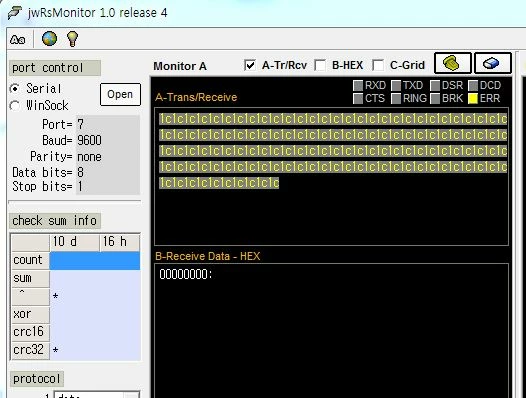

Now I'm trying to implement UART function as the below,
But the problem is keep showing in RS232 Tool.
I'm just referring fully reference posting such as
https://community.st.com/thread/19577?commentID=48791#comment
There's no miss match. But I don't know what is the problem and how to resolve this.
Could you please any advice to resolve this problem?
I guess one thing is there's noUSARTx->BRR declaration.
Is this possible way to happen the problem??

In case TEST 1 and TEST2 have the same output result as the below image.
What am I supposed to do to resolve this problem?
should I have to calculate about
USARTx->BRR

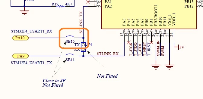

    See here, where you were told about removing SB15
    https://community.st.com/0D50X00009XkXNtSAN

    Can we *PLEASE* keep all your USART related adventures in one thread? Your audience here is limited.
    You would need to make sure HSE_VALUE is correctly defined for the board, perhaps in stm32f4xx_conf.h and be 8000000 and not 25000000. Check also that system_stm32f4xx.c configures the PLL with the expectation of an 8 MHz crystal and not a 25 MHz one.
    Unless you change the bus speeds dynamically you shouldn't need to revisit USART->BRR
    Send an 0x55 data pattern and confirm the bit timing with a scope. Don't send data to the register unless TXE is asserted, you'll just garble things.

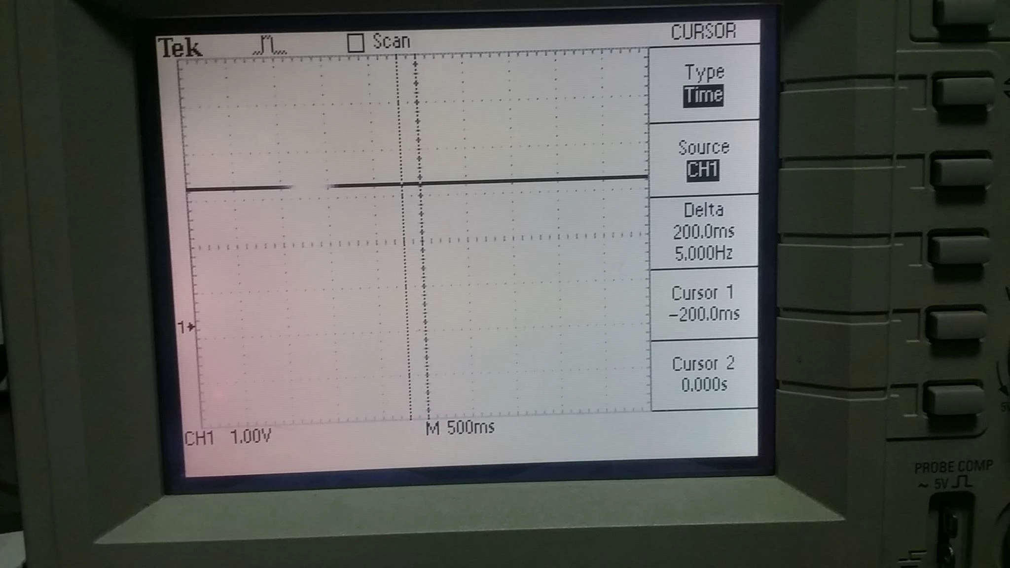

    Clive, I'm struggling to receive data from PC with code below.
    Sending data from STM32 board to PC is working good.
    But receiving from PC has a problem.
    The below image ,  I just prove the PA10 while sending data.
    I'm not sure but would you please check this configuration?

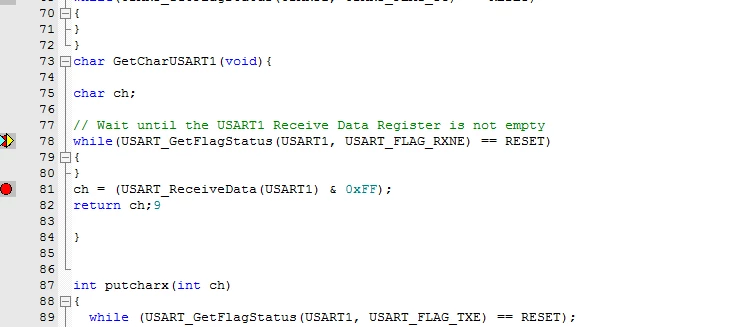

    What am I missing?
    Currently, stuck in here  while(USART_GetFlagStatus(USART1, USART_FLAG_RXNE) == RESET)
    during sending the data from PC to eval board.

    So you show me a static signal on the USART1_RX and ask why it receives nothing?
    Is this pin clashing with the VCP? Did you disconnect the ST-LINK's USART from the STM32F429? Make sure SB15 is *REMOVED*
