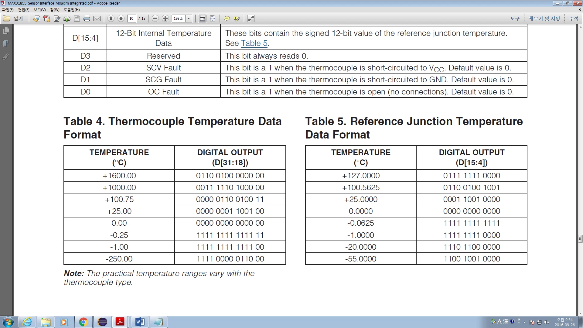

    Md Mubdiul Hasan
    November 9, 2016
    Posted on November 09, 2016 at 09:58
    Dear Sir,
    What a nice code you have suggested! Thank you that you are helping me a lot.
    You have nicely read those raw data, but if we add something for unit, doses it work ?
    double max31855_readCelsius() {
      uint32_t v = 0;
      GPIO_ResetBits(SPI_GPIO_PORT,SPI_CS_PIN);
      v = (uint32_t)max31855_ReadData() << 16 | max31855_ReadData(); // �?¿
      GPIO_SetBits(SPI_GPIO_PORT,SPI_CS_PIN);
      float internal = (v >> 4) & 0x7FF;
      internal *= 0.0625;
      if ((v >> 4) & 0x800)
        internal *= -1;
      if (v & 0x7) {
        return -333; //
      if (v & 0x80000000) {
        v = 0xFFFFC000 | ((v >> 18) & 0x00003FFFF);
      else {
        v >>= 18;
      double centigrade = v;
      centigrade *= 0.25;
      return centigrade;
    Give your comment sir!
