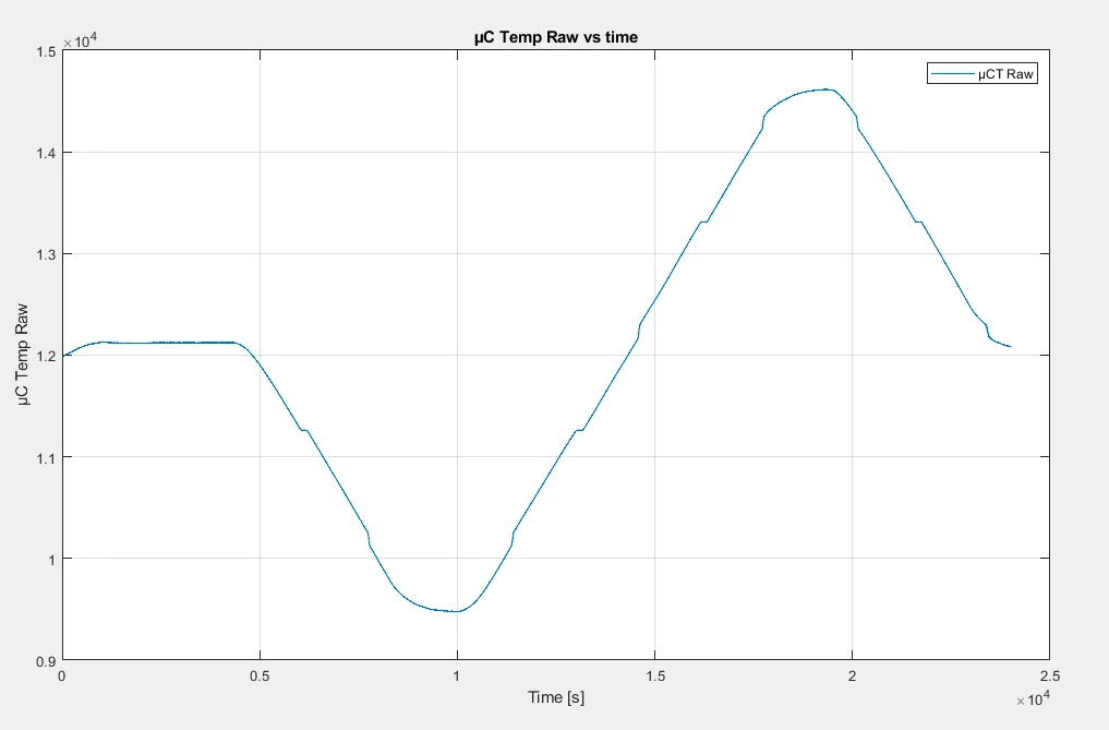

We are characterizing the ADC's in the STM32H7B3 µc. During temperature cycling of the HW we are observing some unexpected shifts in the conversion data from the ADC. The phenomena is observed across multiple HW units in varying degree.
From one part:

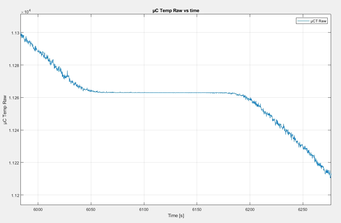

 Zoomed in at the first shift:
It seems 'stuck' at 11263 (decimal) = 0b 0010 1011 1111 1111

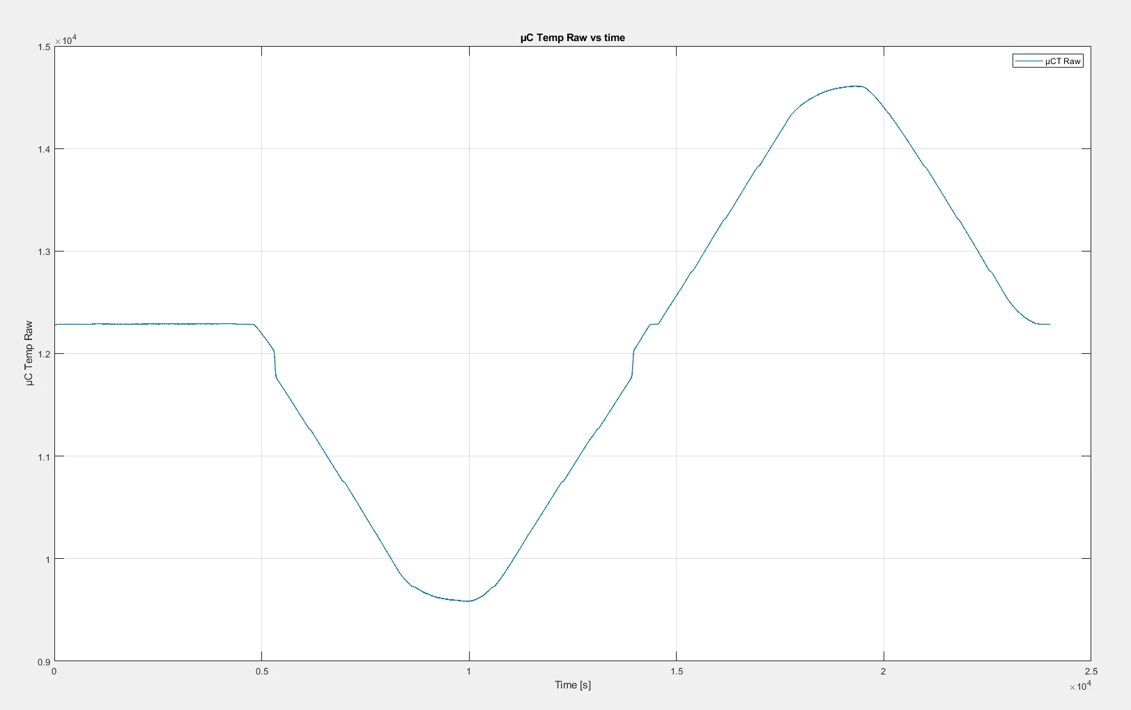

From another part:
It looks like the shifts are occurring at the some distinct digital values. Is seems like there is a tendency that when the 8 LSB of the digital value are all zeros or all ones, a shift occurs. I can provide raw data if this is of use.
Has anyone at ST seen this sort of behavior from the ADC's? If there is a weakness in the design of the ADC's we need to identify it early.
Hopefully this is due to some configuration error on our part.

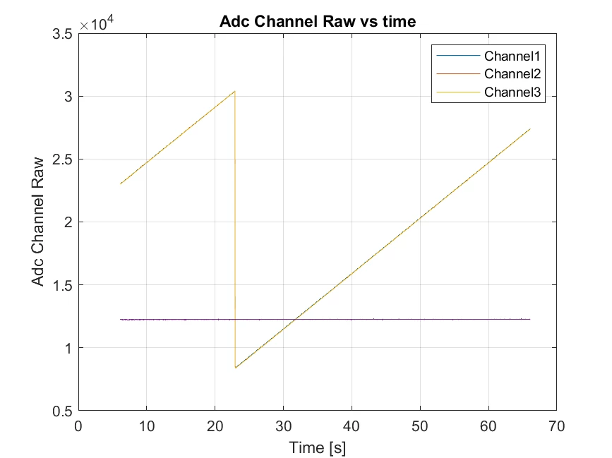

Since the converted µ-controller temperature also has the lost code -shifts, I do not see how the 47kOhm impedance can be the root cause?
I have tried to apply the linearity calibration routine during start-up. It appears that the shifts is no longer apparent:
 I will do more measurements tonight to see if the issue is gone.

Missing codes may be consequence of inadequate reference, but if it can be directly linked to changing temperature, then you may simply need to recalibrate upon those temperature changes.
Btw. I wouldn't be using oversampling for this kind of tests as it may hide some imperfections, and I would use linearly ramping (triangular) input signal.

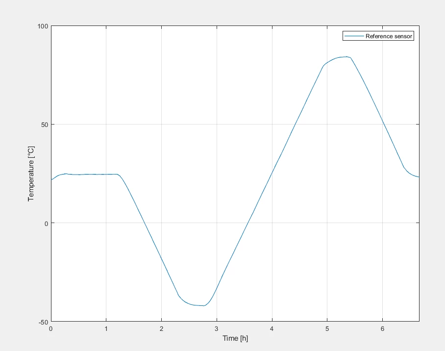

”During temperature cycling of the HW” if possible to have the exact profile of temperature applied . What are the Y axis  of the graphs  ( is it the Converted value ) .

This is data logged from a reference temperature sensor:
We are stabilizing at 25°C, lowering temperature to -40°C, rising temperature to 80°C and ending at 25°C.
The Y-axis is the converted raw value from the ADC.

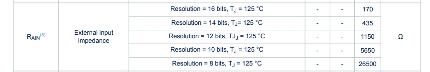

 I saw you are using a High Impedance Input of 47Kohm on the PC3-5 But if you look to our datasheet : you can see that we define Maximum RAIN to 170Ohm in 16-bits resolution
Datasheet - STM32H7B0xB - 32-bit Arm® Cortex®-M7 280 MHz MCUs, 128-Kbyte Flash memory, 1.4-Mbyte RAM, 46 com. and analog interfaces, SMPS, crypto
and I see you are using a big Cext of 100nF which is recommended in our Application Note : How to optimize the ADC accuracy in the STM32 MCUs - Application note  but not sure at this 16bits resolution.    I would suggest to apply Calibration and try for testing purposes to use a low impedance source if the behavior still the same ( only for testing).
Hope it helps you.

"have tried to apply the linearity calibration routine during start-up. It appears that the shifts is no longer apparent:"
>> Excellent finding !
