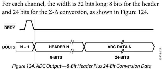

I have STM32H743Z and ADC converter AD7771. I want to use SAI interface for reading data from it. I have configured AD7771, that results form conversions are sent over DOUT_0 line. In oscilloscope I can see line DRDY (falling edge), line DOUT0 sends some data (do not have SAI decoder) and CLK for clock. I connected ADC like that: SAI3_FS->DRDY, SAI3_SD->DOUT0, SAI3_SCK to DCLK.
output data should be in this format (I use 8 ADC channels)0693W00000UFReDQAX.png

Problem is that if I call  HAL_SAI_Receive(&hsai_BlockB3, Buffer, 4, 0xffffff); so nothing is recieved.
What I missed? Where could be a problem?
Thank you very much, Jan.

hsai_BlockB3.SlotInit.SlotActive = 0x00000000;
You have not enabled any slot.

Yes I know, becase I am not sure hot to set up it:
 (I want to read all 8 channels on 1 line DOUT_0)). 1 ADC channel has 4 bytes (1 for header an 3 for ADC data)
I want to use SAI interface. I tried to read data like that, but there are some weird data HAL_SAI_Receive(&hsai_BlockB3,(uint8_t *) GlSAI_DMA_Buff, 8, 0xffffff);
What I am not sure about is:
  • hsai_BlockB3.SlotInit.SlotActive - What does it mean? I want to have 8 channels on DOUT_1 line - so there is 32 slots? Or all this "pack" is taken as 1 slot?
  • hsai_BlockB3.Init.DataSize - for me it should be 32? (1 channel sends 4 bytes)
  • hsai_BlockB3.FrameInit.FrameLength = 256; - it sounds good for me when I want to read 8 channels (1 channel have 1 B header and 3 B for ADC data) 4x8x8 = 256 bits
  • what bout that? hsai_BlockB3.FrameInit.ActiveFrameLengt
  • what bout that? hsai_BlockB3.SlotInit.SlotNumber

hsai_BlockB3.Init.DataSize = SAI_DATASIZE_8;
hsai_BlockB3.SlotInit.SlotNumber = 32;
The hardware supports a maximum of 16 slots. Obviously for 8 channels one has to set... 8 slots! And, if you want the whole 8+24 bits of data, then set the data size to 32 bits.

 Finally solution - works for 8 channel on 1 lin (1 channel is from 32 bits)!

 hsai_BlockB3.SlotInit.SlotNumber = 8;
 hsai_BlockB3.SlotInit.SlotActive = 8;
 hsai_BlockB3.SlotInit.SlotActive = SAI_SLOTACTIVE_0|SAI_SLOTACTIVE_1|SAI_SLOTACTIVE_2|SAI_SLOTACTIVE_3
		 	 	 	 	 	 	 	 |SAI_SLOTACTIVE_4|SAI_SLOTACTIVE_5|SAI_SLOTACTIVE_6|SAI_SLOTACTIVE_7;

hsai_BlockB3.Init.MonoStereoMode = SAI_MONOMODE;
hsai_BlockB3.Init.MonoStereoMode = SAI_STEREOMODE;
hsai_BlockB3.SlotInit.FirstBitOffset = 1;
hsai_BlockB3.SlotInit.FirstBitOffset = 0;
hsai_BlockB3.SlotInit.SlotActive = SAI_SLOTACTIVE_0|SAI_SLOTACTIVE_1|SAI_SLOTACTIVE_2|SAI_SLOTACTIVE_3|SAI_SLOTACTIVE_4|SAI_SLOTACTIVE_5|SAI_SLOTACTIVE_6|SAI_SLOTACTIVE_7;
I would not call it a good example. And the .SlotActive = 8 is just plain wrong. Also assigning SAI_SLOTACTIVE_ALL should also be OK.
